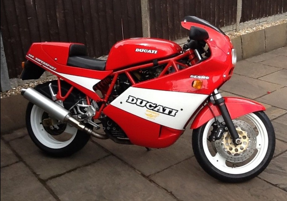

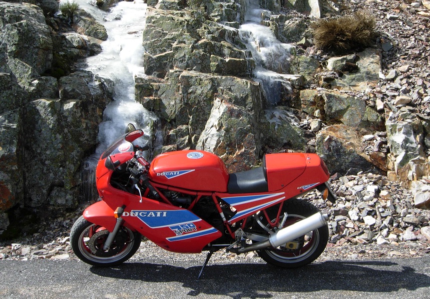

I want to get back on the road with my ducati 750 Sport, which I had in a corner of my garage.
I have come back strongly, and I bought a 900 Supersport 90 in England.
As an amateur mechanic, and with his help I think I can get ahead, with the return to the road.
On my return, I run into some problems, mainly spare.
I found the square tooth straps, for me 750, but not for the 900,
Can someone tell me the reference or if they are compatible with another model?
I do not even find the headlight for the 900, I searched the forum, and I have not seen any solution, maybe I did not look well.
I live in Spain, and the light of the English lighthouse, to circulate on the left, is not legal here, I have to change for a European lighthouse.
If someone in your country circulates on the left you have a European, I would gladly exchange it, or I can buy it.
I think that to return, I've bored them enough with my message, and it's time to present my bikes.
My language proficiency is not fluent enough, I hope you can understand me, I apologize.
A greeting from Spain

Btw. that is a nice and clean looking 900SS
