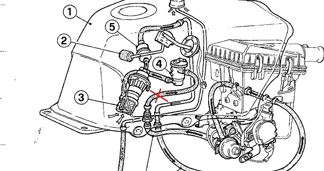

A vacuum problem builds up after a bit of riding. Usually it let's the engine stall completely after a while. Opening the tank cap when the problem occurs will make the engine run normal again.

Tried the vacuum issue solution. No change. The issue appeared once when the engine had just started.

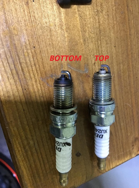

Spark plugs came out with bottom one to be black and wet and top one to be white and overheated.
Any suggestions on where else to look are more than welcome!

Top cylinder spark plug is white and too lean and bottom is black and wet.
I am starting to think that the reason the bottom cylinder stops working is due to fouled spark plug.

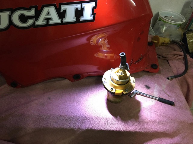

Tonight I removed the injectors to send them for inspection and cleaning.
I also removed the fuel filter precautionary to replace it from inside the tank only to find out the anti-vapor valve to be disconnected. I don't know if this could be the source of the problem though.
- anti vapor.jpg (95.15 KiB) Viewed 48430 times
- spark plugs.jpg (162.19 KiB) Viewed 48430 times

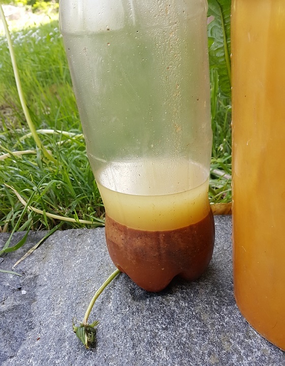

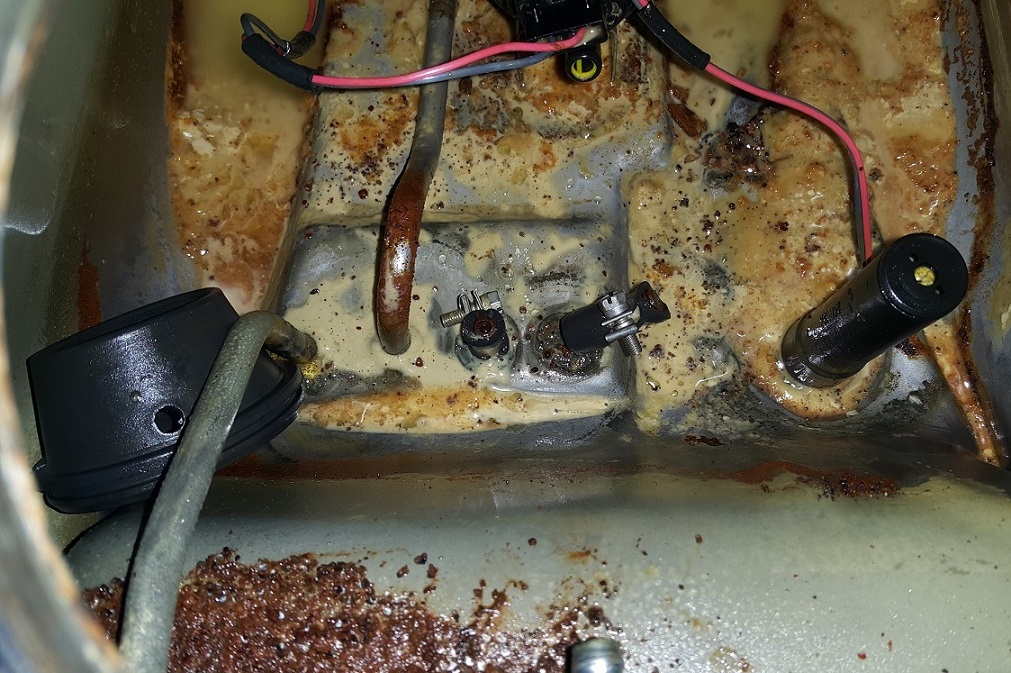

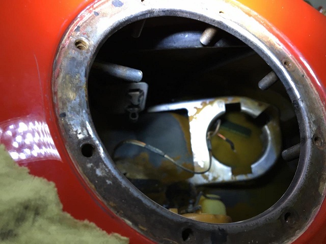

I finally find the time and as soon as I look in the tank I immediatly see something I dont like.... I start taking out the fuel and I I find.... shit, literally...
Pump, fuel sender, all was clogged. the vent hoses from the fuel cap to the tank were missing and the connections inside bloked by rust and muck, I am not sure how the fuel did not go out (it if did it would have been a very nice big ball of fire...) inside the tank all hoses were bloated and the pump mesh filter was full of muck.
I disassembled & cleaned everything, 2 hours later it started perfectly...
I am still at a loss, how is possible the thing could run with all that water and mud... plus, the injectors are in series.. why was it running with one only? I dont get it.
Now the bike is fine, I hade to refurbish the tank and I might need a new TPS, or just some tuning (has a small flat spot at 1/3 of throttle at 3500RPMs)
Thank got it was fully bloody serviced...
This little story just to underline the fact that often we dismiss the simple things...
Here are pictures of the tank and the muck I too off, the bottle was a 1.5L just to give the idea of the shit that was inside

Apparently the filter had not been replaced when I took the bike to an authorised Ducati workshop (first and last time) and asked them to check and replace everything as the bike was sitting for some years.
