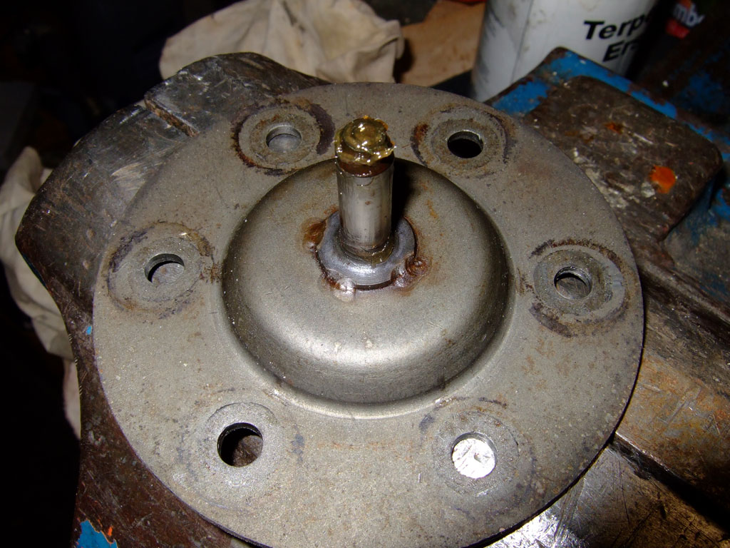

Re: Clutch Preasure Plate Repair
But again, I'm missing something but is welding so difficult?
It might just be the current global situation and the lock down. For a while you couldn't find an open shop. Maybe in some places it's still so.

MC tool,
You could consider brazing, the diameter of the hole is 16mm and the diameter of the "mushroom" is 20mm, so an overlap of 2mm.
Should work and if it doesn't it's easy to remove the 2 parts with a "little" heat.
Problem for me is that I have no idea why the weld cracked in the first place.
Bad welding material, cooling down etc.?
Posts: 2033
I think the welds break/crack because the spigot is welded to what is a thin bit of steel plate and it flexes a bit during use, maybe because the clutch springs are not all the same strength and sorts cocks the plate /pressure plate assy . Anyhows I did think about getting a large steel washer and welding it in there to stiffen up the plate. I guess if you wanted to get serious you could check the springs on something like a valve spring tester to check them for uniformity .
