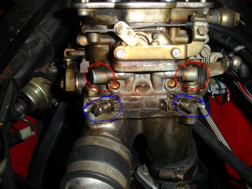

2. Are there any other screws I need to note the position of besides the ones circled in this photo?
Don't want to start from scratch.

2 the screws shown are the idle mix screws and the throttle bypass screws . The idle screws should be reset as per manual ,there is no real point in recording their position now as cleaning will alter the actual fuel flow and they probly aint right anyhow. The bypass screws are to ballance the two venturies and one should be fully closed , and the other opened enough so there is equal air flow in both venturies .....so probly not a whole lot of point in recording them either , specially if you plan on removing the throttle shaft and plates. Once you have stripped and cleaned the carb its real unlikely that the before settings would remain correct after the stripping and cleaning....one would hope not otherwise why bother

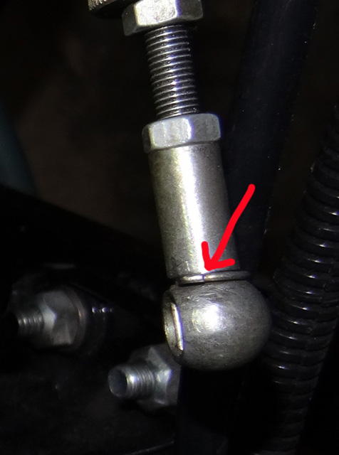

don't just pop it off. Remove the clip first.
- DSC00735.JPG (88.91 KiB) Viewed 10839 times
Re: Carb rebuild + throttle linkage
+1 remove the clip first

Wot firetruckin clip !? Mine dont got no clip ,just sorta sits there

I didn't pop it off bks it didn't feel right. Thanks for the heads up on the clip.
