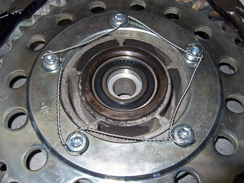

Re: Rear Sprocket bolts all sheared off
I did this many years ago.
