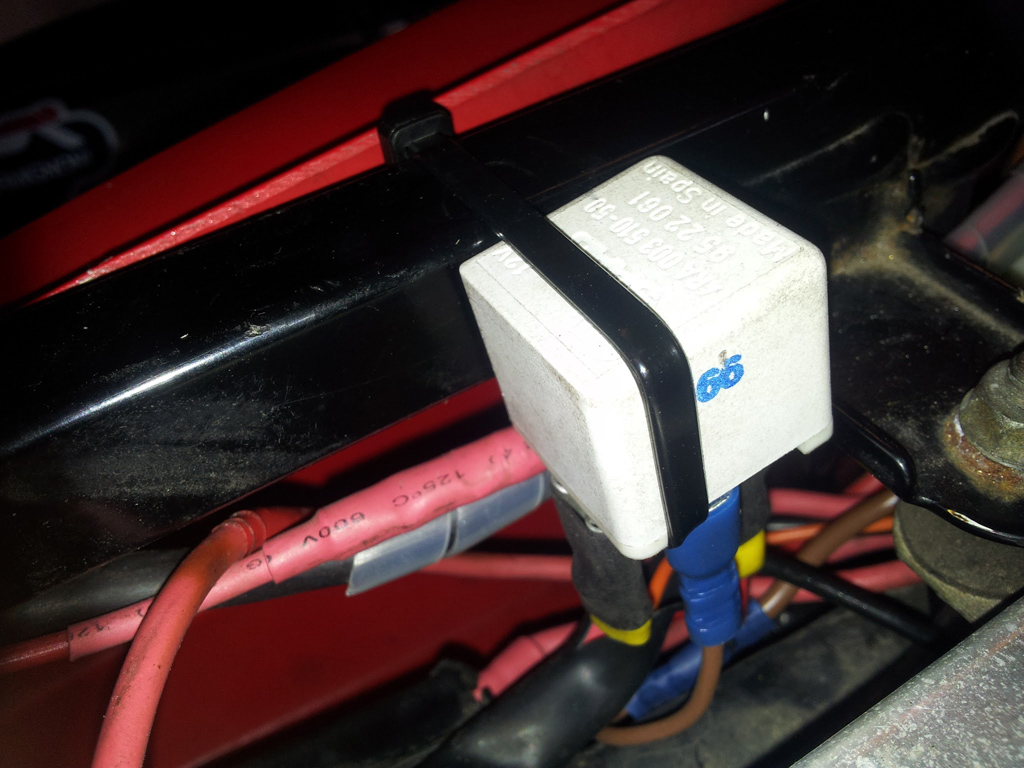

Re: Ignition Switch electrical mod.
Just removed the upper windscreen and headlight
and found an easy to get to place on the wire to mount the relay and wiretie it to the mounting frame for the front part of the fairing
I cut the wire close to the fuse box and mounted the relay under the seat.
Why do you guys want to run wires from the ignition switch? All the wires you need access to are under the seat at the fuse box. Take a Tee off the red blue wire at the back of the fuse box from the main fuse to pin 30 of a 30A relay. Cut the brown wire that goes from the ignition switch to the switched fuse. This can be a few cm from the fuse box Connect the ignition switch side of the brown wire to pin 85 of the relay and side that goes the fusebox to pin 87. Connect Pin 85 to ground and mount the relay in a suitable location, that's it. At ignition on the relay points will close providing power to the switched fuse, bypassing the ignition switch and no need for long wires
