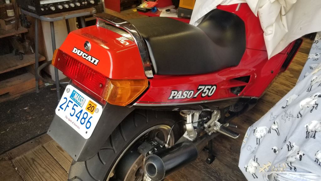

I did the Euro conversion on mine and am very happy with it. The turn signals blend into the body work much more naturally. Mine too had the saggy, likely aftermarket signals.

Re: 750 Paso Rear Turn Signal Indicators
That looks good. I just ordered a Euro tail light from an outfit in Belgium. Cheaper than stock replacements, which are almost impossible to find and apparently break immediately anyhow, and a fraction of the cost of sourcing one here in the U.S., even with shipping.
