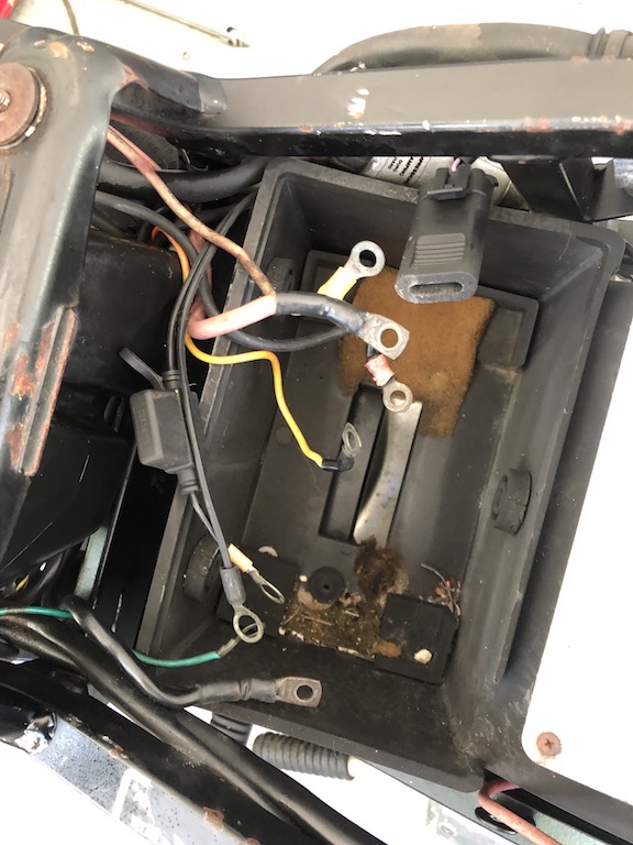

Haha. Thanks for the reply. I had already planned on doing that. The engine has compression and I changed the oil and there are no metal flakes. Now I am cleaning out the fuel tank. All in all, so far so good. The most puzzling thing is that there are about 5 cables with the positive cable. Is this normal? Ive never seen this before.
Re: $100 907ie
sounds like the po did some changes or additions. You will have to trace them out to see whats been done.
I have 3 on the battery ground and 3 or 4 on the positive for changes and upgrades I have done sorting things out over the years.

Very interesting. Thanks Higgy. I assume that I just connect them all together on the positive battery terminal, correct?
Re: $100 907ie
According to the wiring plan there would be 3 wires on the battery's + terminal. If you connect them together better be sure what they are for, specially if they are not red.
I would like to know what they are supplying first and if they are fuse protected and grounded properly to prevent an unintended consequence. Fires are common on such older machines. Rodents enjoy chewing on wiring

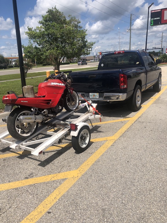

Thanks for the help paso750. Here are a few photos of the bike.
- IMG_0289.JPG (176.39 KiB) Viewed 332569 times
- IMG_0292.JPG (123.61 KiB) Viewed 332569 times
- 64876045686__3EF68960-1F59-4A60-A4CE-2FB568DA82AA.JPG (204.63 KiB) Viewed 332569 times
Re: $100 907ie
It looks a bit rough but a good basis for a restoration. Finding the missing parts isn't a problem.

So I changed oil, belts, spark plugs, and added fresh fuel. I tried to start it today with a good battery but to no avail. The headlight and dashlights come on. However, the fuel pump doesnt prime and the engine doesnt turn over. I do hear clicking when I turn the ignition switch to off or on positions, but I hear no clicks when I hit the starter button. I read in another post that if the kill switch isnt making good contact, the fuel pump wont prime and the engine wont turn over. Is this correct or should I look elsewhere? Thanks in advance.
Re: $100 907ie
Have a look at the wiring plan. The kill switch connects to one of the two fused relays. You should check their 15A fuses first and then all in the fuse holder. Check them with an ohm-meter not only visually as sometimes hairline cracks can be overlooked.
Disconnect the yellow/red wire from the starter solenoid and check if there's 12V on it if you hit the starter button. If there is you should hear a click when it's connected back on the solenoid. If there is but there's no click the solenoid is not ok. If there is and you can measure 12V on the wire to the starter, the starter motor is not ok. The brushes could be worn or in worse case the windings shortened.
Edit: As I just saw in the wiring plan the 12V that are passed on to the starter solenoid when hitting the starting button come from one of the two fused relays so definitely start there.

Re: $100 907ie
Thanks Paso 750. I looked at the wire connected to the starter solenoid and there was a tremendous amount of rust. So before I do anything else, I am going to clean all the electrical contacts I can find including grounds. After that, I will try it again and see what happens. If it has the same behavior, I will do what you say. Thanks again.
