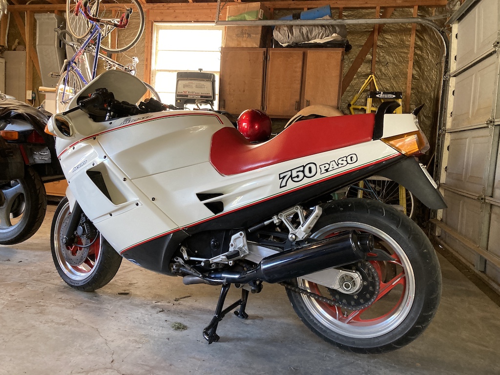

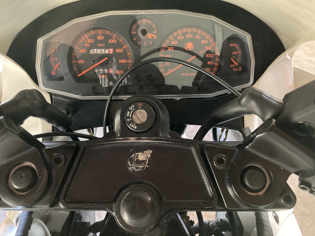

OK, I'm dumb; attachments are easy. Couple pics for fun. I'm loving this bike.

Re: 1988 Paso - First Ride
Great job and she looks beautiful.
The bike looks and sounds great, Richard. I especially like the mufflers. It's good to know there is a more attractive yet stock looking alternative to the originals.
