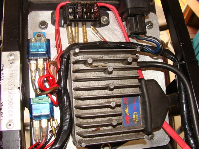

Thank you for your suggestions. They are mikunis from a 900ss and running fine. I did the simplest mod as per the instructions FAQ ( basically providing 12 v directly to the coils via a relay). What a transformation! The old girl fires up within a revolution or two as opposed to the 4 or 5 seconds previously. I don’t quite believe what a massive difference this has made. The acid test will of course be on cold Monday morning. The wiring mod is actually even simpler than I assumed with no cutting or messing around with the old harness, just disconnecting the original coil leads and running a wire up to the switched side of the relay. Then the new leads (I used 2mm csa) I will post a couple of photos tomorrow. Many thanks again and for readers in the future this mod does make a difference.
