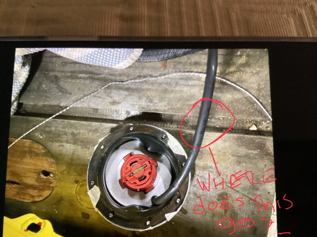

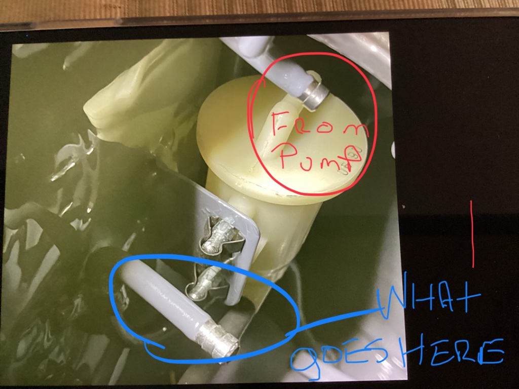

I removed tank on my 907ie to have some repairs and liner done on my 1992 907ie. Well that’s been 6 months now and I can’t remember the inside connections. Any insight would be greatly appreciated. I know that the top tube in the tank on the right is for the feed end of the pump. Then the return line goes to the degasser and from that it goes to the bottom screen of the pump. I don’t remember where the cap drain line goes or what connects to the pipe in the middle of the opening. Here are a couple of photos

If you have the owner's manual check the picture on page 29 or the workshop manual p.9.
You'll find those on top of the 907IE forum in the FAQs.

Thanks Paso. Looks like that line from the fuel cap drain goes to the blue circled tube I pictured.
