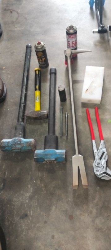

Ok The axle is out. I used break free and CRC spray over the period of 12 hours, slowly "feeding" it into the axle Little spray, go away, come back little spray and so on. Used a syringe to try and get lube in there as well. I did find some lube had penetrated but What got it out was a bloody big heavy sledge hammer and plenty of hard hits...took ages. tried lighter mash hammers, not a chance. The big boy got it out. The threads of the axle are good, the axle itself is a rust ridden thing but will polish up. My self and 2 friends were needed, one held the drifts, I swung the hammer and the other supported the bike on the paddock stand. Pray the front is easier!

I'm hoping the photo loads to show my tools of the trade. Delicate...not. yep, the biggest hammer was used, all the way down to a 27 gauge syringe.
