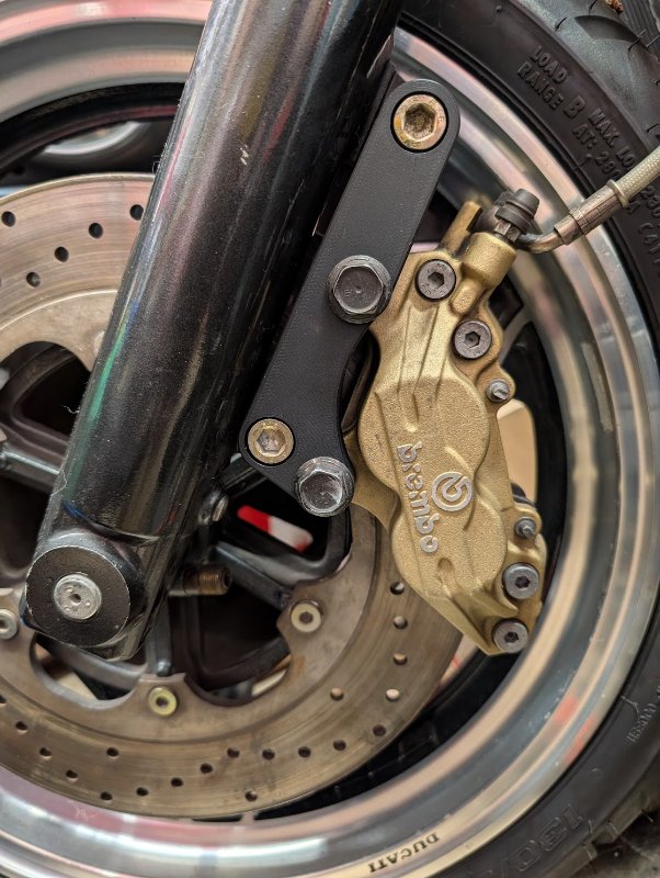

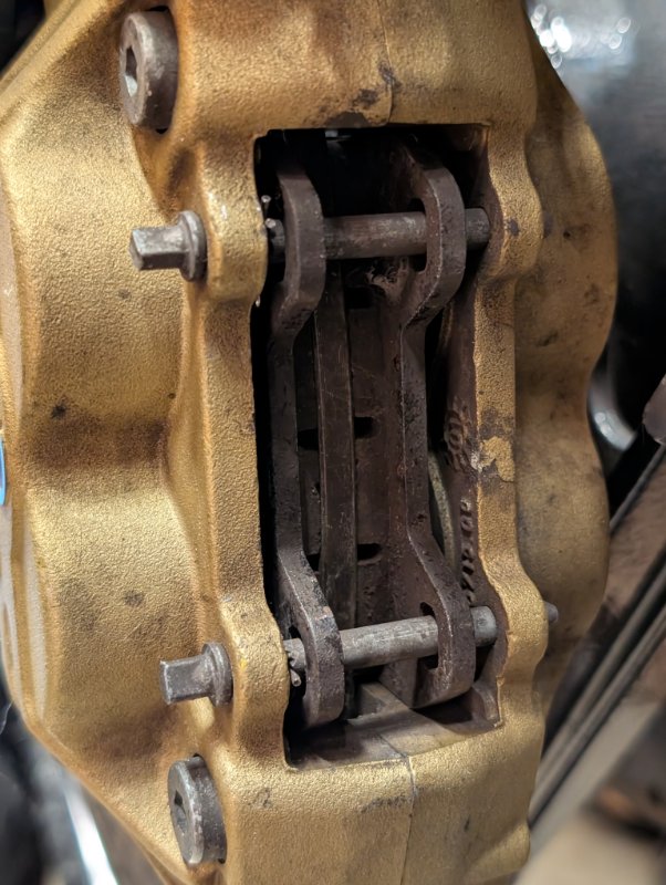

In the past year of having the Paso around, I've obtained a set of 65mm Brembo from calipers from a Monster. The 40mm spacing calipers were a bit more expensive as I got these with the master cylinder for $150. I saw they did make an adapter for the 40mm calipers but I couldn't find a definitive answer if the offset was the correct one for the stock Paso brakes and 16" wheels. With that in mind, I opted to use my 3D printer and design/ print out a set of mounts for the 65mm ones. As you can see it fits quite nicely. My only concern here is, how far from the edge of the brake rotor should the pad sit? The new pads won't go as far close to the center of the rotor so I don't have to worry about intentionally too far away but I wonder, is there a standard or an ideal amount it should sit away from the edge? I might change the design up to sit a little closer, maybe a millimeter or two but otherwise I'm a bit happy. Any thoughts? Thanks!

The adapters look the ducks nuts. From the photos, the friction material of the pad looks to be about central to the brake surface of the disk, so you would have to assume maximum brake force is applied to the disk. As the adaptor is from a 3D printer, I assume the material is plastic? Will the material be able to handle the temperatures the brakes will give off with a bit of spirited riding? A soft/melted adaptor wouldn’t be a good thing to have.

The finished part will be made out of aluminum, either by myself or someone I know. Right now just being able to print it out to prove the design is my goal. I think I'll move the caliper in the millimeter just to be sure the distance from the top edge of the pad is at least half the thickness of the rotor. The pad depth is much smaller than the P8 pad so I've got quite a bit of room to play with.

Im sure someone made them , I recall having to run downstairs and have a quick measure of the SS calipers I had because I was looking at pix of both 40 and 60mm adaptors ,I also sure that by flipping the adaptors they could be used with 320mm discs and the stock Paso discs .😁

I saw that someone had made them but what I could find, that was for calipers with a 40mm spacing. 65's are a bit more plentiful from the later Monsters.

paso750 wrote: ↑Tue Apr 07, 2026 6:06 am Did you see the downloads topic on top of this forum? You'll find different brake caliper adapters there.
No I did not but I DID find the answer I'm looking for in the specs of the calipers. Centerline of the pistons to be inline on the same diameter circle. So I need to have the first piston(30mm) be 2.5mm from the edge of the rotor and the second(34mm) one be about .5mm. Also seeing the mounting specs will help fine tune my drawing more and probably end up rotating the mounting locations. I really never would have that print specs would be around, wow. Thanks! :beer:
