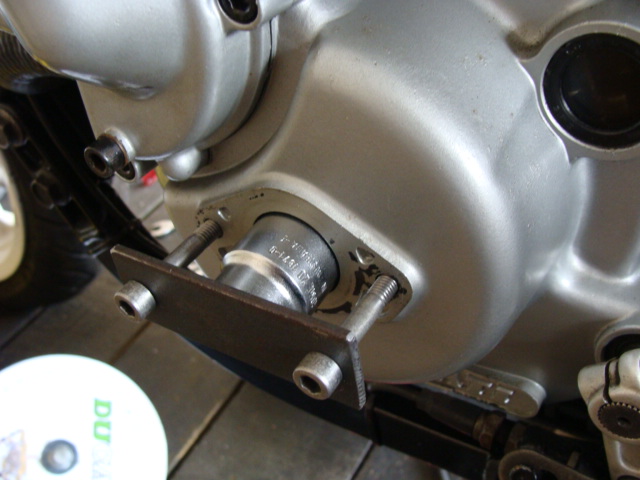

I made this simple tool to pull the cover off using a socket as a mandrel. The bearing should be exposed to engine oil so I would remove any seals on the bearing before fitting . :)
