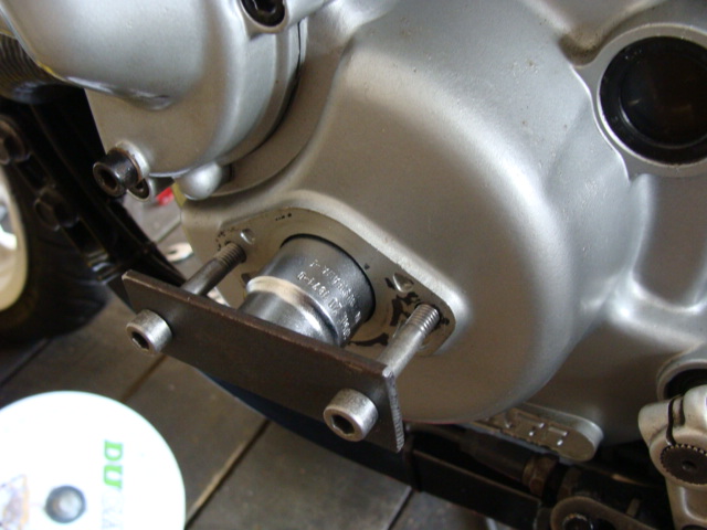

Dude , if your willing ( and able ) to crack the cases then you'll find the belts are a piece of piss. you should suss where the oil is actually coming from as there is no real point in pulling bits off and replacing gaskets and seals if that's not where its leaking. Probly the only issue would be getting the LH cover off as there is an outrigger ( ball )bearing on the end of the crank ... just under the wee cover with the 2 screws in it ...... sometimes they are able to be pulled off but some sort of puller can be fashioned

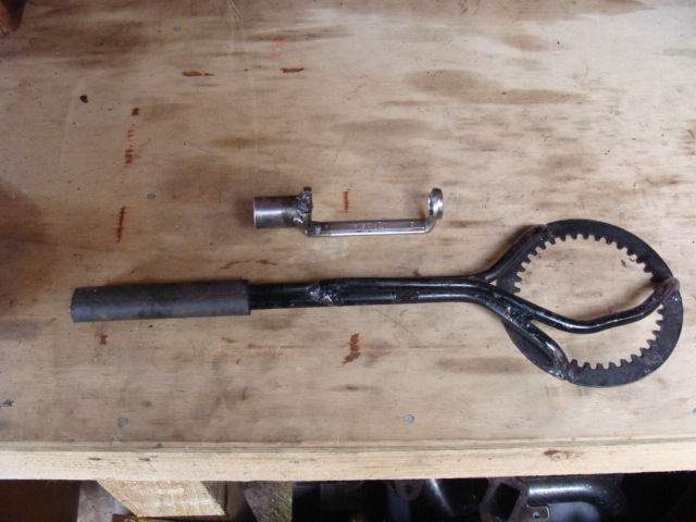

The 3 pin cable is probly correct for an older belt drive , my paso has 3 wires too . I made a clutch holder out of a old plate . The kink in the middle brace is so you can get at the clutch nut .The best way to suss oil leaks is to give the donk a good spray down with water soluble degreaser ( super cheap auto's ) and give it a good hose down ( not a water blaster ) and go for a ride and see where its leaking . Im not aware of any known disaster zones

The other thing in my pic is a tool for removing the head retaining nuts . If you make a clutch tool give some thought as to the length of the handle as you can use the foot peg bracket to rest the handle on making the removal of said nut a much easier job
