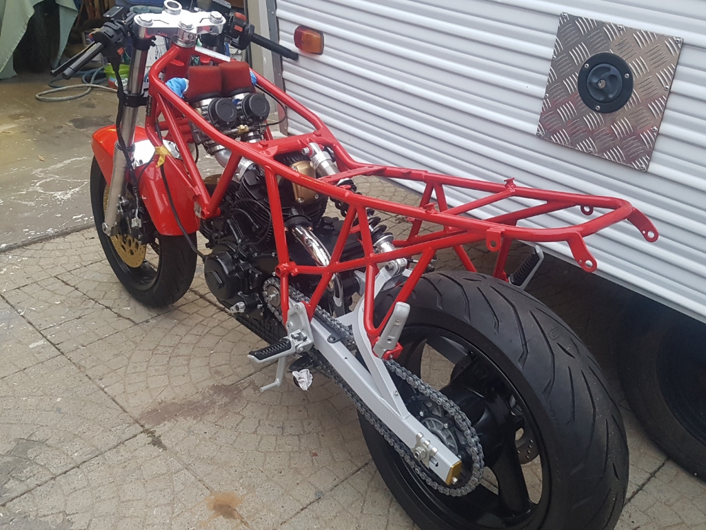

Test photo of ducati
Test photo
Test photo

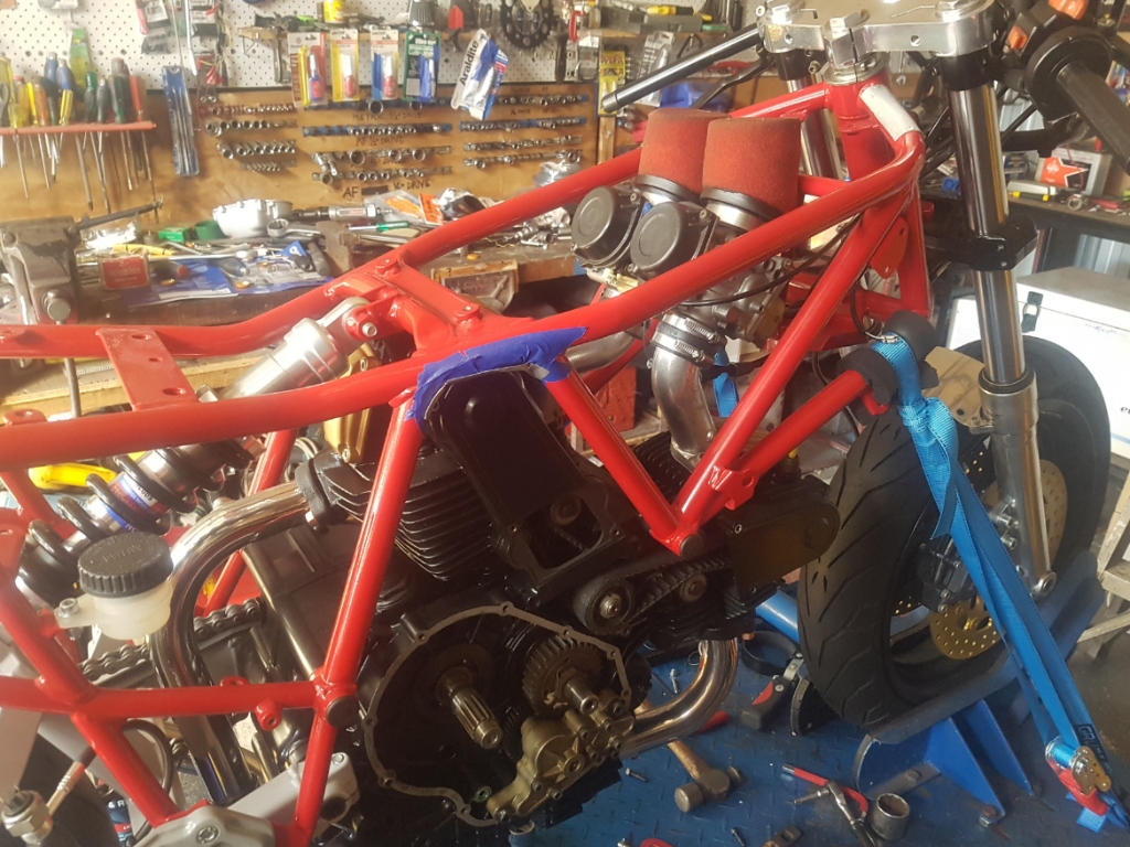

Pickle me grandma, just playing around with the phone and look what happened

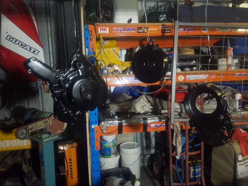

First daylight in 12 maths

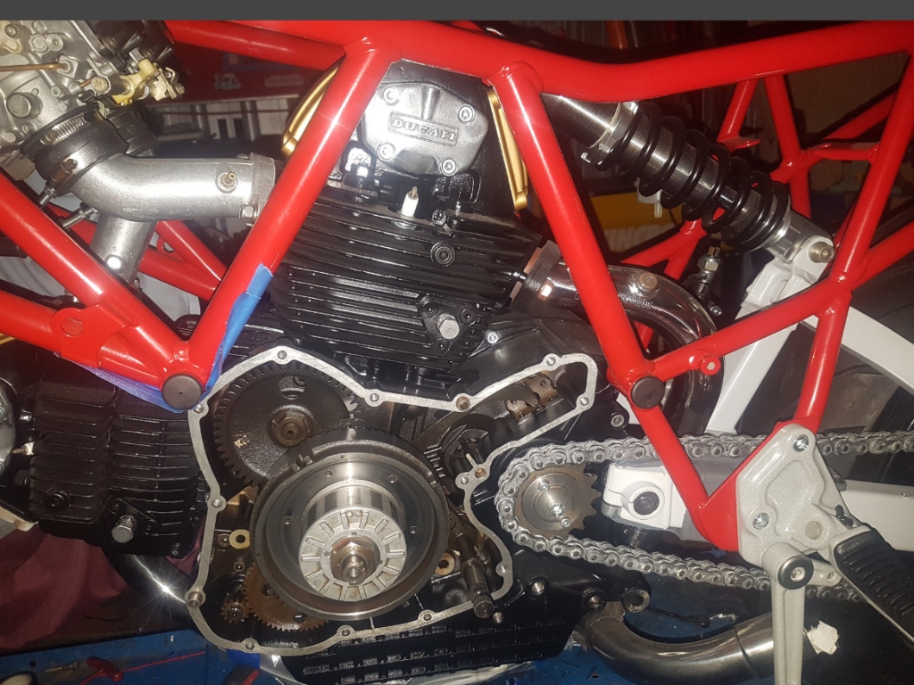

Covers nearly ready for refit bar a couple of runs then I will fit alternator cover first then concentrate on the clutch side, things happen pretty slowly lately , restoring both trade and cage trailers , and signs to reinvest guzzi money to get back on my feet, restart my painting business also recommissing pressure cleaner and airless
