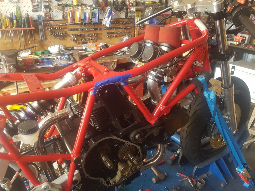

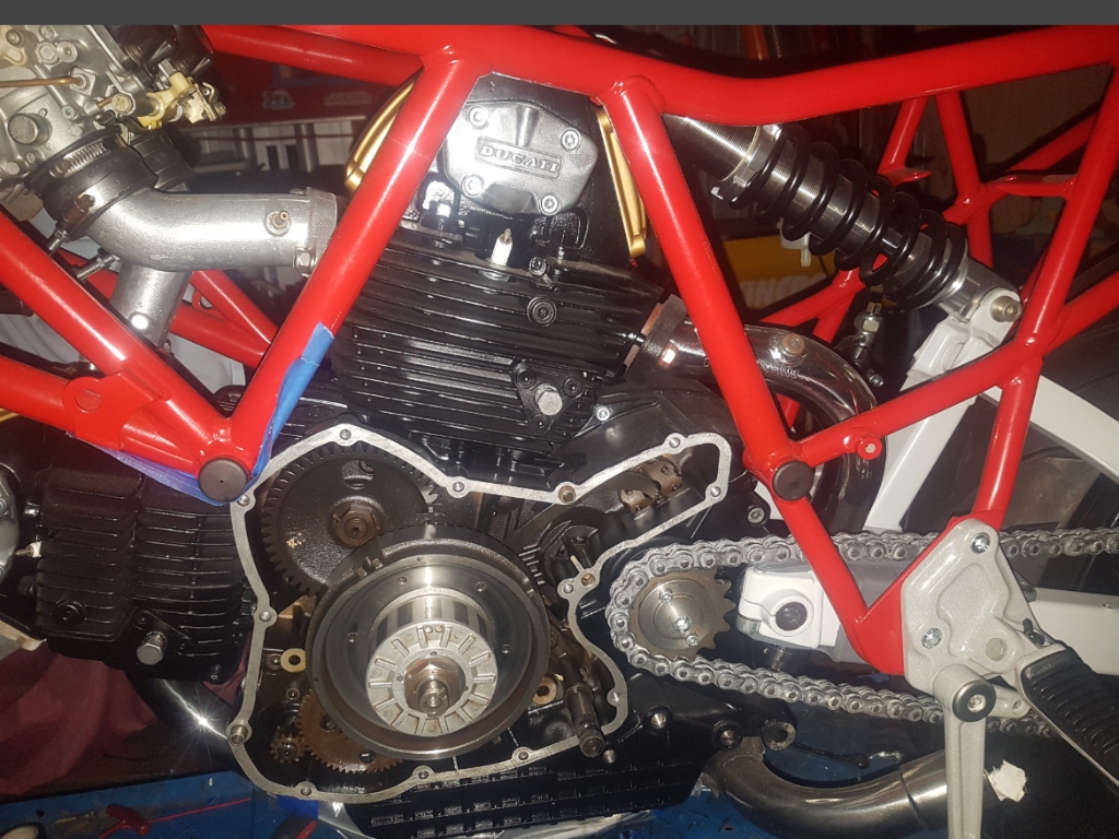

Test photo of ducati
Test photo
Test photo
Re: Oil leaks 89 900 ss
Posted: Sun Oct 15, 2017 1:01 am
by HIGHWAY89
Pickle me grandma, just playing around with the phone and look what happened

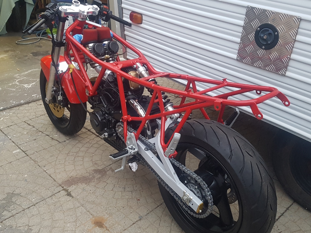

First daylight in 12 maths
Posted: Sun Oct 15, 2017 4:11 am
by HIGHWAY89
I think I'm getting the hang of this, be asking me to stop soon

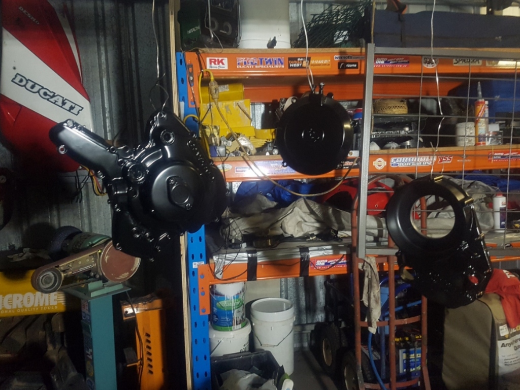

Covers nearly ready for refit bar a couple of runs then I will fit alternator cover first then concentrate on the clutch side, things happen pretty slowly lately , restoring both trade and cage trailers , and signs to reinvest guzzi money to get back on my feet, restart my painting business also recommissing pressure cleaner and airless
