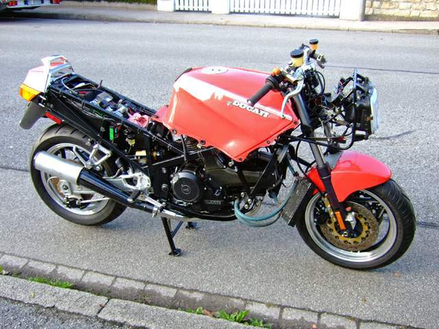

Looks beautiful but could you be so kind to post some overall pics of your bike? :oops:
Having seen all these details makes me wonder how she currently looks like.
From a distance or with the fairings on or off the bike looks like any other which is why imho these pics are not that interesting. These are older
