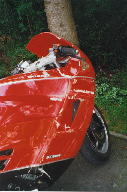

It was so much fun to the point where it ended on a blind summit. First my talent reached an end and then the tarmac.
The things I learned that time: 1: do not chase cars no matter how much fun it is 2. always keep in mind that on a summit there can be a sharp left turn 3. cars go better through curves even if driving too fast 4, forget the many years of Vespa scootering and never hit the rear brake hard in a curve. The streak of rubber could still be seen 2 weeks later.
I was lucky that I took down only an electrical fence and landed in a field. Cows got scared, I was fine - the bike not.
Right fork leg had some light scratches, front fairing was smashed – something actually punched through it, the tank was dented, brake lever bent, rear brake lever partly broken off, exhaust scratched, one steering stop cracked and the right mirror had disintegrated.
I actually rode it home like that (very carefully). My dealer is on the way home so I stopped there with grass still hanging out every crack of the bike. He had a laugh. “didn`t you say you polished it 3 days?” – a**hole

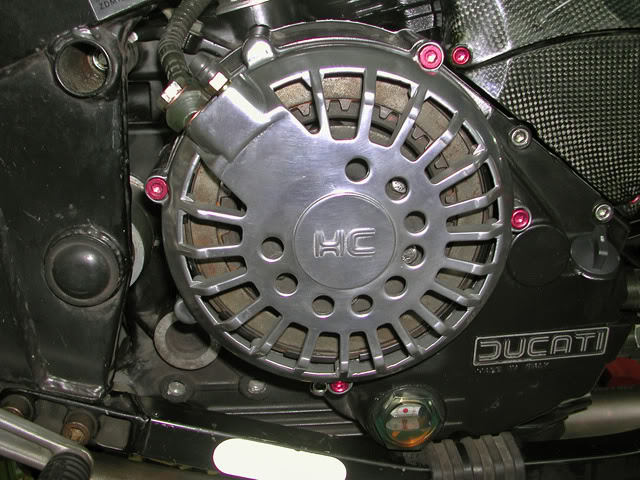

• Open clutch cover (round holes)

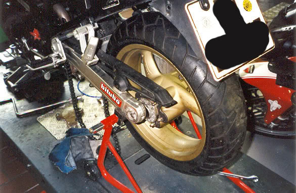

Around 2005 I thought about converting to 17” wheels after Michelin announced that the original sizes were to be discontinued.
I got a set of wheels from a Supersport with a 4.5” rear and a 160 tire but I didn`t like that at all. It may have improved handling quite a bit but I just didn`t like the tire to be narrower than the Michelin. Also I didn`t like the looks of the 3 spoke wheel on the Paso.
I got a 5.5” rim and we tried with a 170/60-17. It fitted and looked much better but I still didn´t like it. After getting the grey Marchesini 5 spoke rims from a Monster S I gave up and decided that it will be 16” forever. (Maybe it would`ve been different if I had found rims that matched the design of the Paso better – I doubt it though. The small wheels look so right on the low bike)

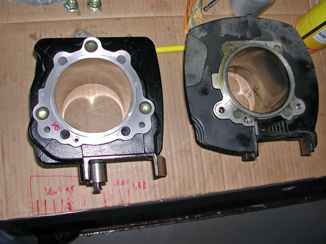

• 780cc kit (for Supersport/Monster – air/oil cooled hence some small mods to the engine case required)
• Cylinders painted black (came silver/grey)

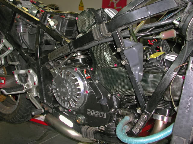

When I got the engine back I started to reassemble the bike and it was about ready to be ridden again when I figured it was quite silly to have a brand new spanking motor combined with all the other old parts. Hence, I decided to strip it again and give the frame to sandblast and powdercoat, which took a very long time due to the powdercoater but the result was worth waiting.
Meanwhile I started stripping everything else and I mean everything! Not one single bolt remained untouched and not one single part that could be disassembled wasn’t taken apart, cleaned and rebuild again with new bolts and seals. (rear brake cylinder and the fork rebound adjuster had some sludge inside as did the engine before)

• The open clutch cover with the round holes was replaced with a nicer one

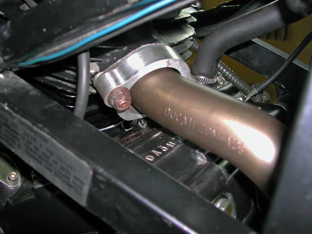

• The headers got an alloy mounting bracket instead of that rusty steel part

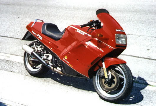

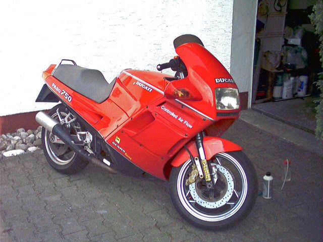

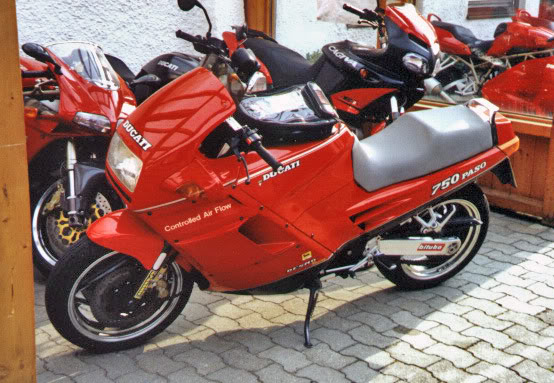

Here the first pics

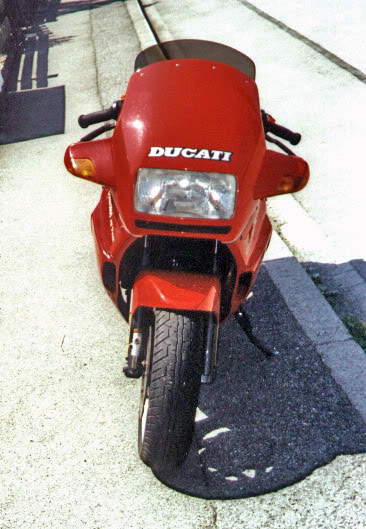

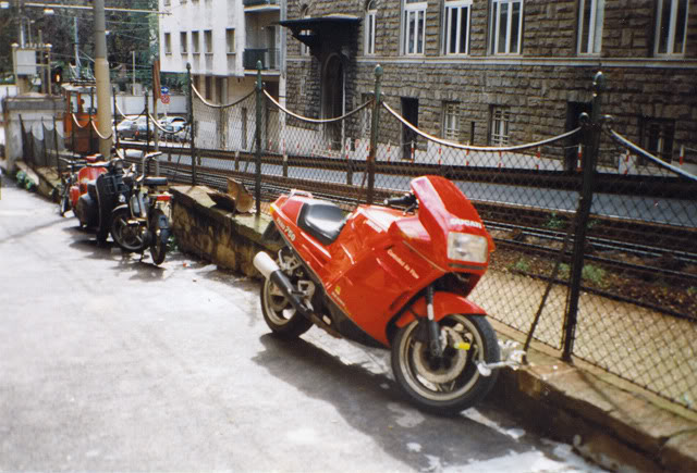

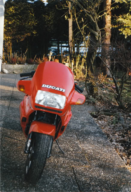

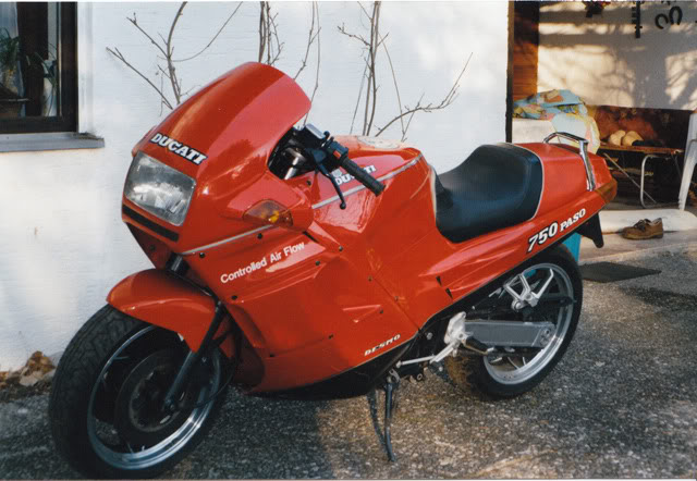

the bike just after I bought it (still my favourite pic)

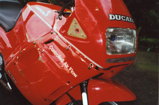

the bike after testing its offroad abilities - they sucked

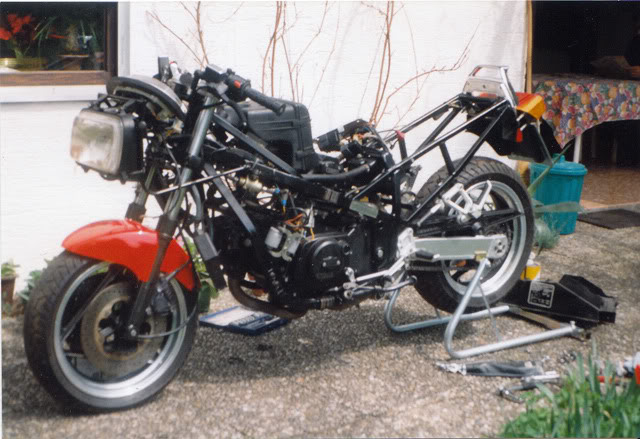

starting repair

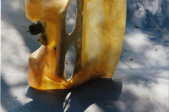

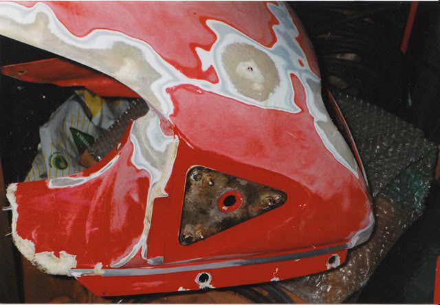

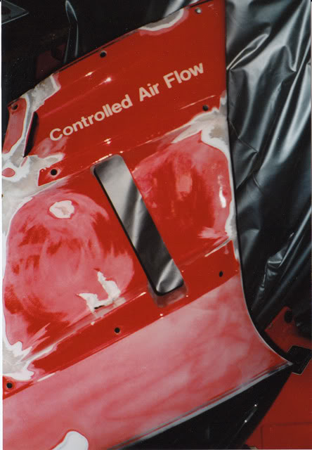

back on the road w/ Vitaloni mirrors (new tank from a 906, front and side fairing repaired and painted - the red was a little darker)

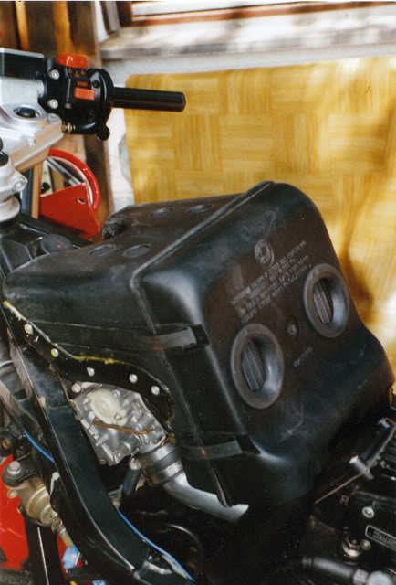

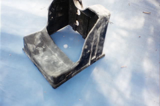

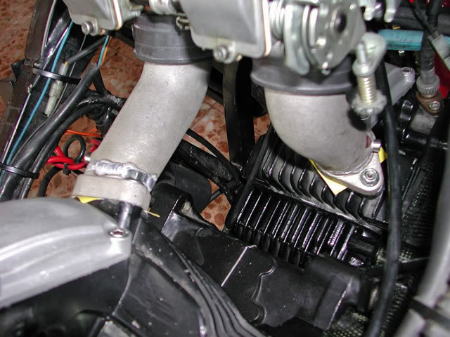

Mikunis and airbox (performance wise a smaller airbox is not what you`d want but the bike ran just fine and easy over 190km/h. A good friends 906 with high comp pistons, Keihins and small K&N cone filters only went 208km/h. With an airbox that would`ve been different).

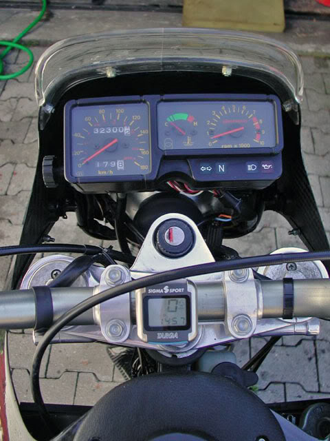

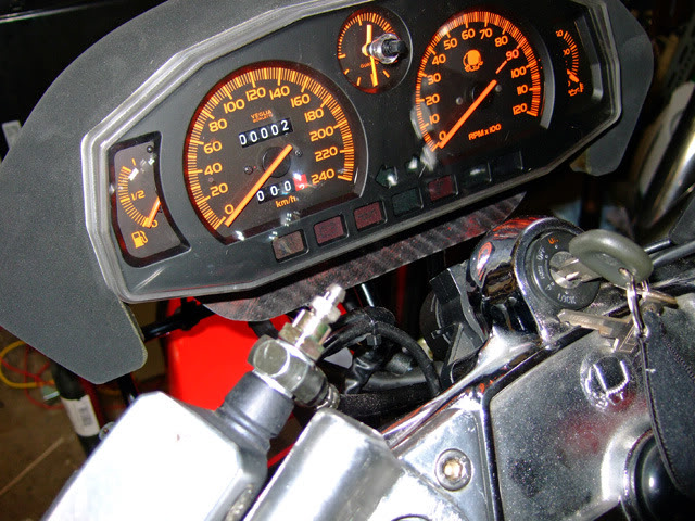

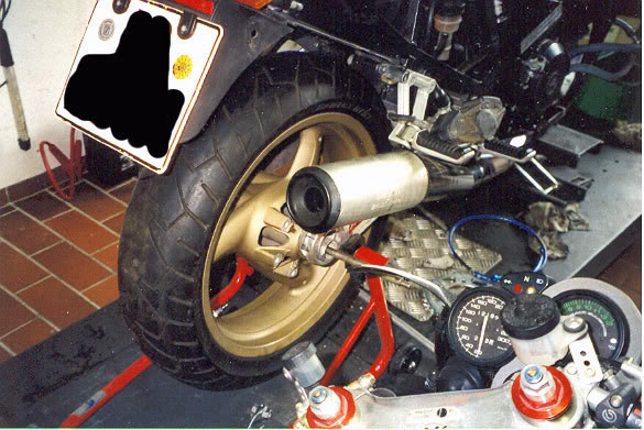

The wires on the side went to a small digital voltmeter I was using when I had problems with the regulator.
improvising

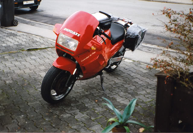

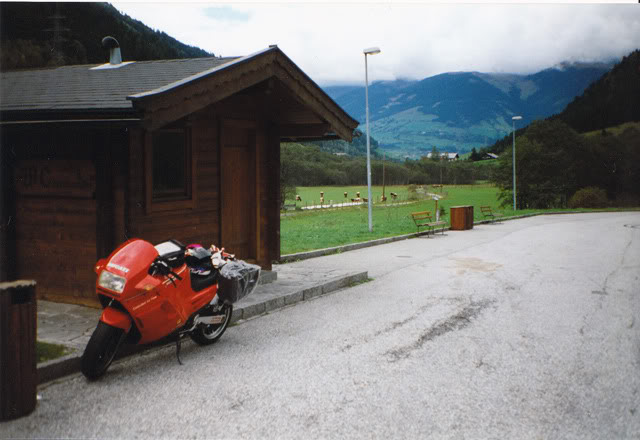

First trip to Trieste, Italy end of september 2000. Beautiful weather and so much fun. The ride back beginning of october was the exact opposite. It rained most of the time and in the mountains it snowed. Carbs iced and the engine ran on one cylinder. Then the starter broke down and couldn`t be fixed (starter brushes were worn). I managed to get home having the pushstart the bike everytime the engine stopped. I swore to myself never ever to cross the alps on a bike at that time of the year again.
Noticed also that soft bags are crap (at least mine). They come with a rain cover but that doesn`t cover the inner side. The wheel constantly sprays water to it until the bags soak. If again, I`ll put my stuff in an additional plastic bag.

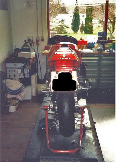

safe, w/ brake disc lock and chain :mrgreen:
the short wheel conversion attempt (original wheel vs. 17"x4.5" with a 160 tire)

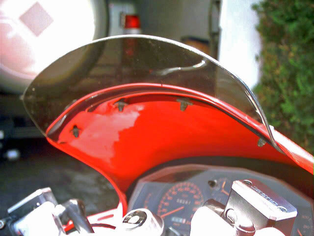

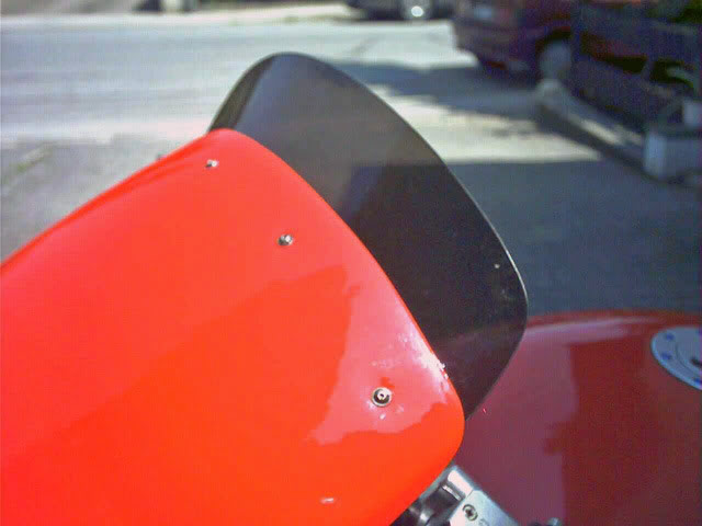

adding the front screen. Some may not like it but it`s definetely an improvement at higher speeds.

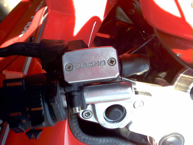

4 piston Brembos. Back with a 907ie seat also. I love the Corbin but the seams are not waterproof. The seat foam will soak and although it looks dry after it rained you`ll have wet pants when you sit on it. I`ll have the seams made waterproof when the Corbin will get a new cover.

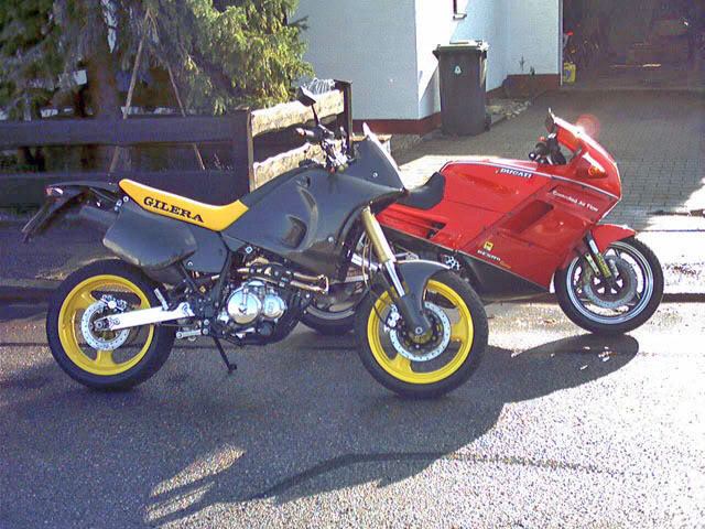

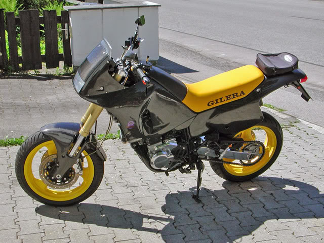

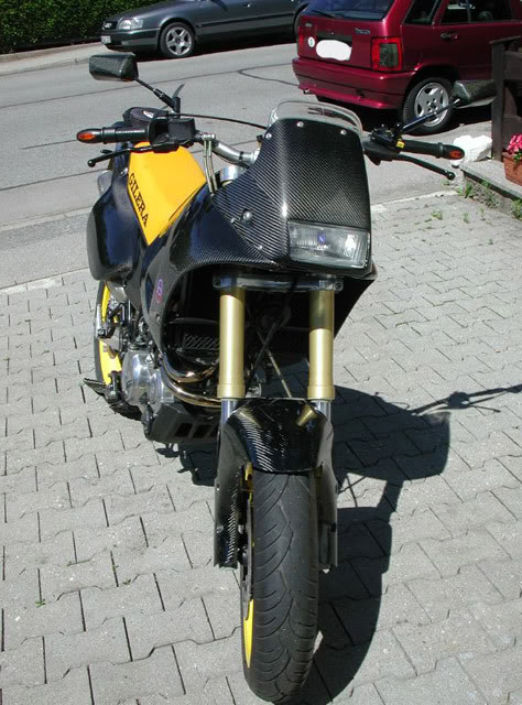

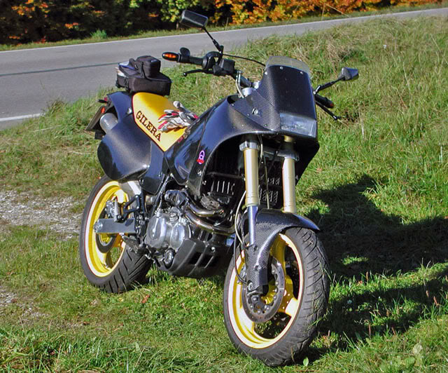

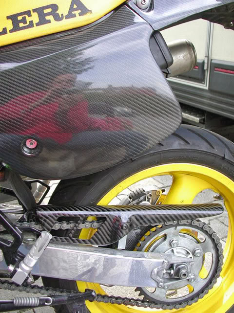

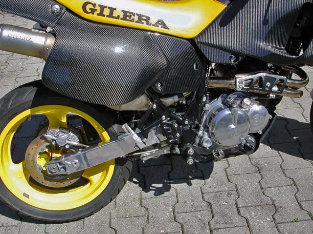

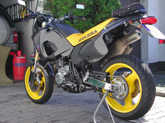

the Gilera Nordwest. Offtopic but it belongs to the story. The bike was sold last year. I loved it but missing fuel gauge and one cylinder is not for me (as long as it`s not a scooter). It needed min 4-6000rpm to start moving well but then was lots of fun. A very easy handling bike btw. Top speed almost 170km/h.

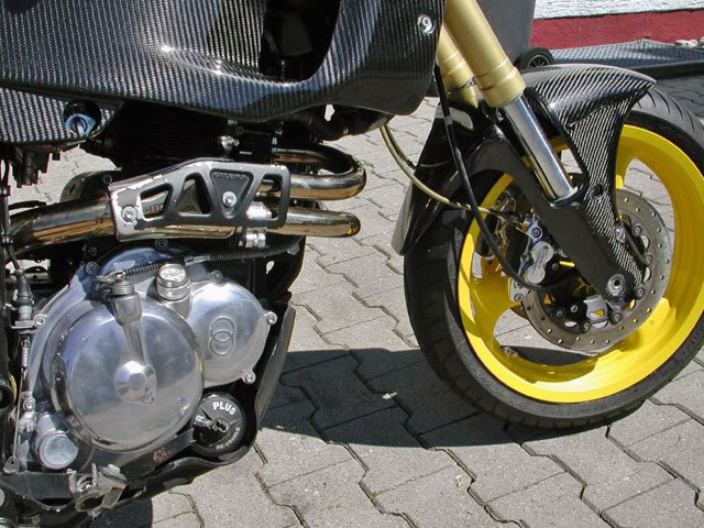

new Contis for the Paso (one still can see the darker red painted front side fairing)
The bike shared some minor similarities like a small headlight fairing, square headlight and side air inlets

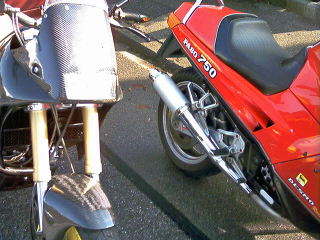

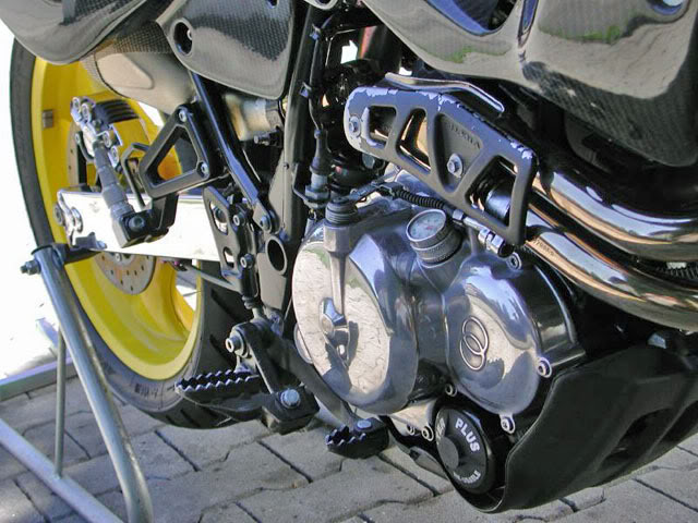

self made CFK chain protector
carbon also under the fairing

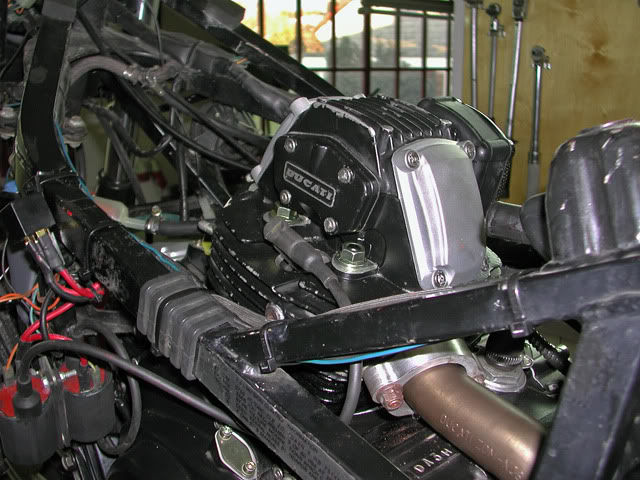

Re: my Paso - a never ending (love) story ...

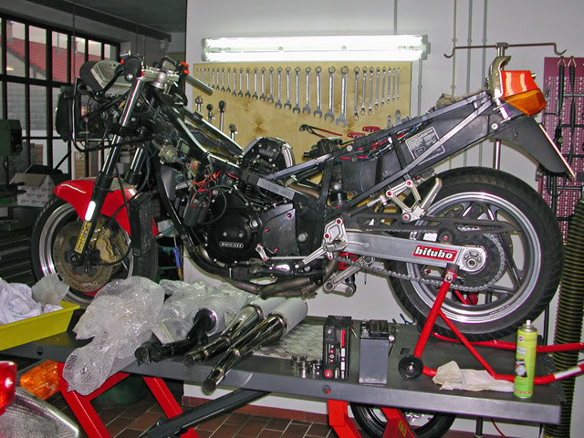

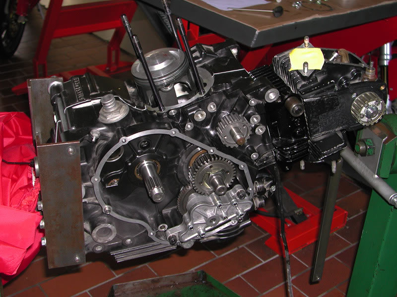

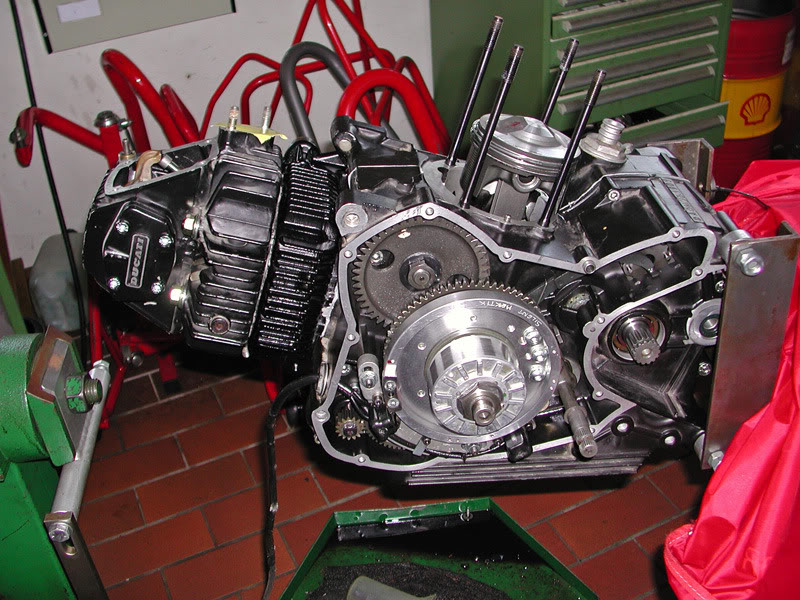

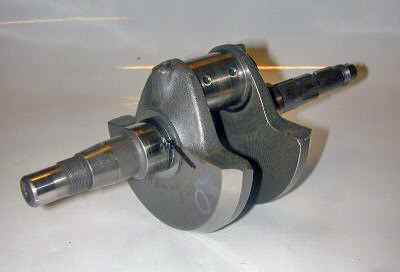

the engine rebuild

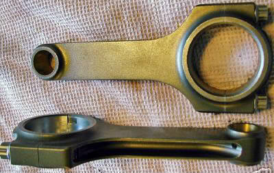

Carillo rods (amazing how expensive those special bolts are - one was missing)
slightly lightened crankshaft
Silent Hektik alloy flywheel, 460g

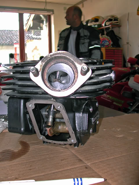

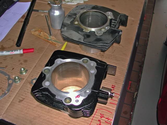

780cc vs. original cylinders
bigger valves

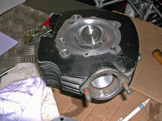

ported heads
adjustible cam belt pulleys
back in the frame (don`t ask me what all those red bolts were about - they`re all gone)

I recongnise that airbox mod from the tech section - I thought that might be yours! I'm planning the same thing but keep putting it off (man I hate fibreglass).
I see what you mean about the 4.5in rear with 160/60. Does look narrow compared to OEM. Worries me a bit as that's the way I'm going with my 906 (had a spare set of wheels from a 600SS rebuild.) Hmmmm....more food for thought to go with ducin thebays thoughts on the 120/60 front.......

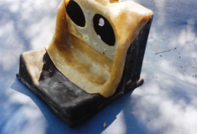

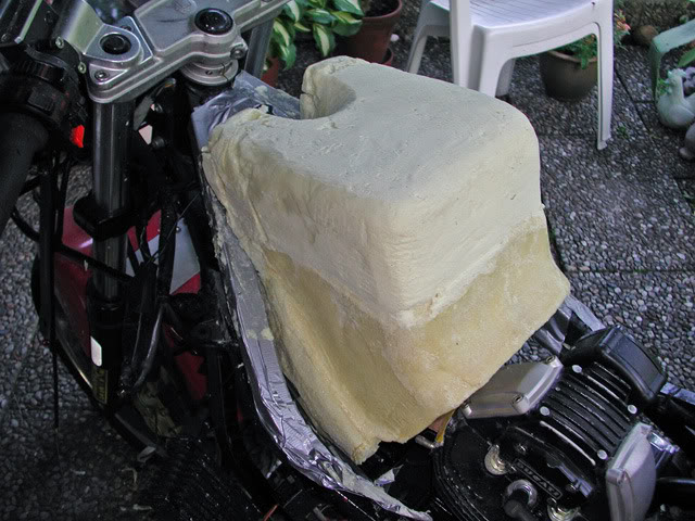

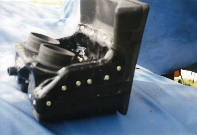

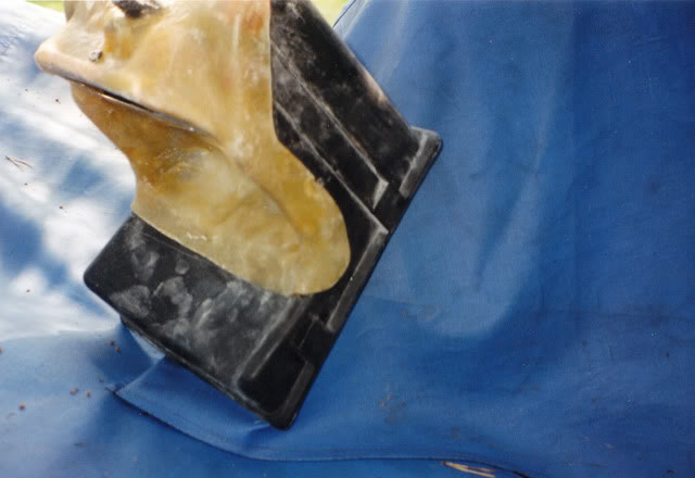

Mick, I understand your point. I didn`t like working with glassfibre either. But the airbox is not much work. Mine wasn`t a masterpiece of craftmanship but it still exists and works fine after over about 12 years now. Enough time to improve my skills.
Regarding tires, narrow ones handle better (as long as they aren`t mounted on a rim that`s too wide).

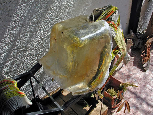

When fitting the new TDMRs I figured a much bigger airbox would be nice. So I build one. It`s 90% finished but it`s over a year I didn`t touch it, at least.

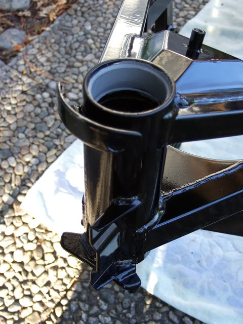

Copy of the tanks lower side on a 906 frame I had bought. Except to an engine case I had every part double either as spare or as old parts from my bike which were replaced with new ones (like ie full gearbox - which I was lucky to find cheap as that was exactly the time when Ducati cleared their old stocks). So I thought I could build another one but I scrapped the idea later on and sold that frame again.
The basic foam shape to start a new airbox from

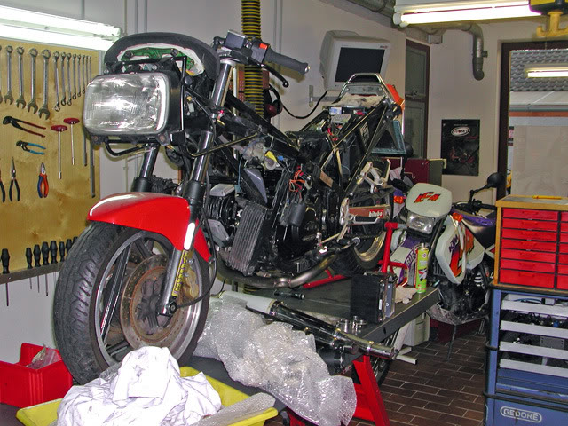

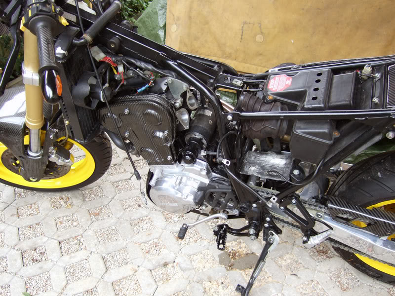

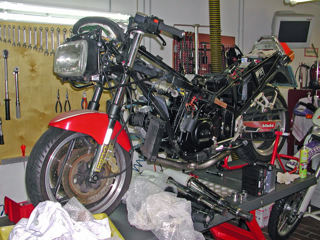

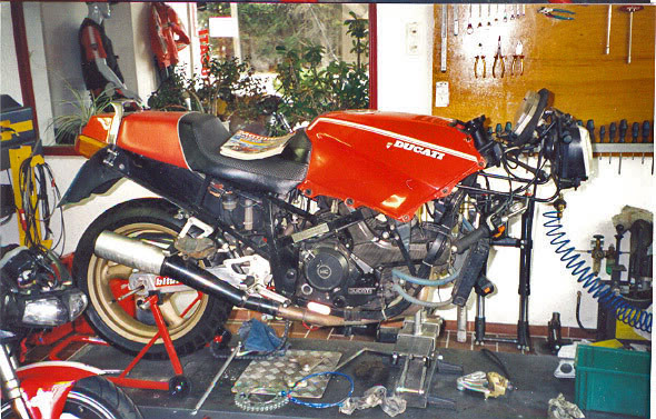

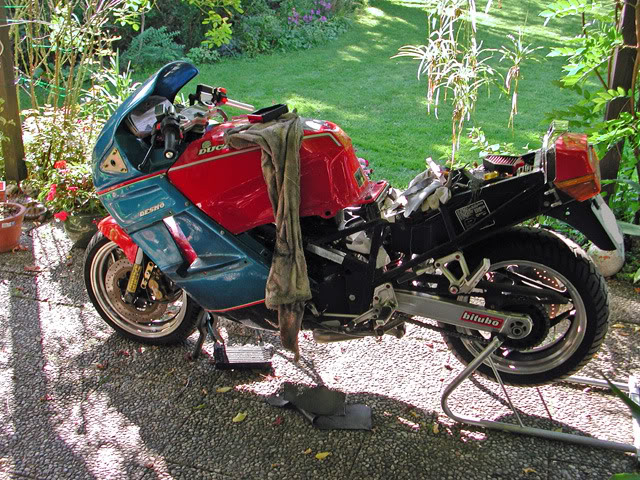

The Paso in its working dress - some old fairing parts used when working on the bike

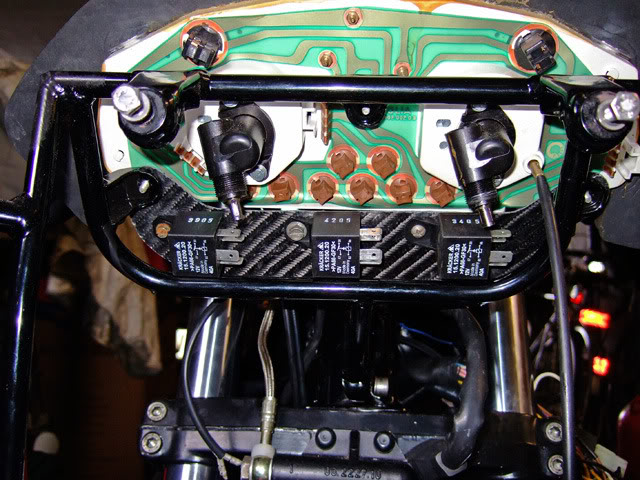

Experimenting with positions for the additional relays

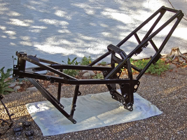

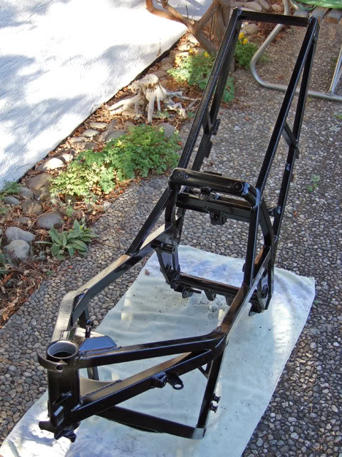

Then completely stripped again - the frame back from powdercoating (a painter estimated €350 for the work, powdercoating costed less then €100). Putting the bike back together then went pretty fast.

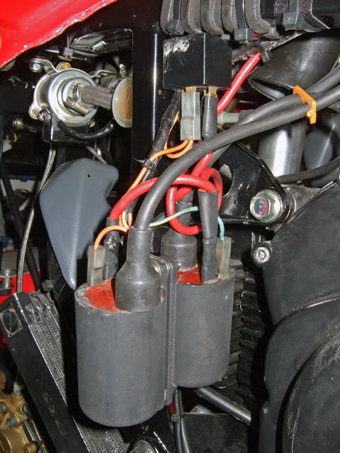

coils & relay mod (http://www.silent-hektik.com/)

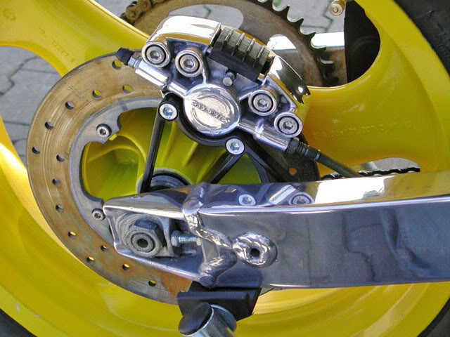

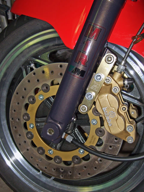

rebuilt front end w/ MQ (MotoQuailty - Brembo) steel braided brake lines

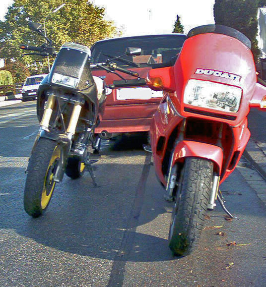

The Avons and the now too short side & center stand. This must have been last fall. Both stands were replaced with the ones from a 907ie which were of course sandblasted and powdercoated to meet the rest :)

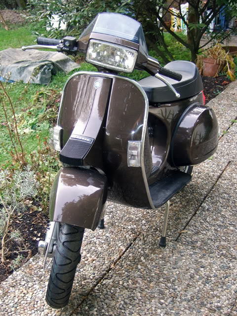

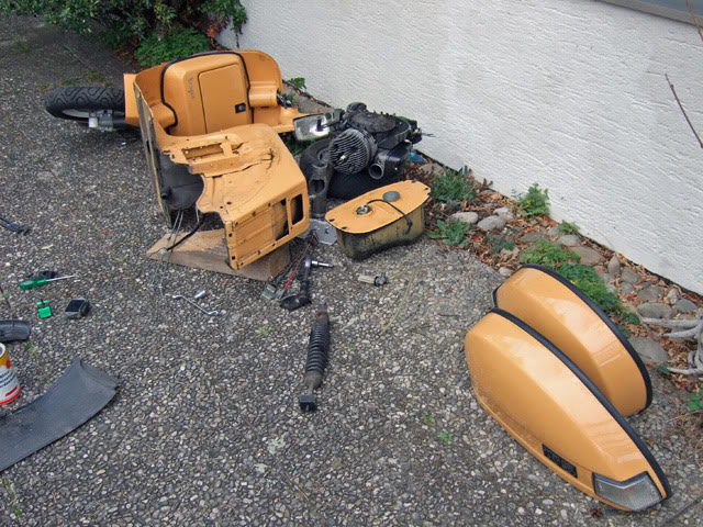

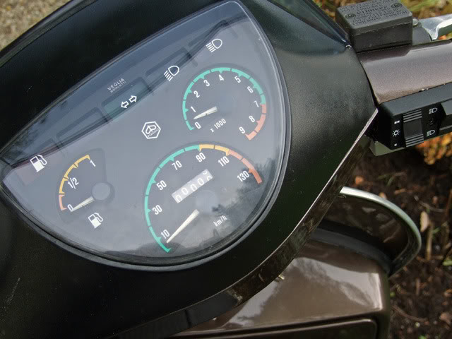

offtopic again:
the Paso obviously not being enough of a project and the Gilera being finished I finally got myself a Vespa again. This time a 125cc T5. Other than the Paso and Gilera also a rare model but rather sought after being the fastest 125cc Vespa Piaggio built (12hp).
I wanted the T5 just for short rides so I registered and used it - for exact 3 days. Then I decided I didn`t want to ride around on a scoot which owner obviously didn´t care much about its technical condition. Instead it had 3 layers of paint on it.
Learning from the Paso that if, one should do it right from the start on day 4 it looked like this. Except to the bare main frame, seat, front rim, engine case, gearbox and clutch everything went off to ebay and was replaced by brandnew parts.
After almost 2 years (the painter only took about half a year) it looked like this.
Meanwhile it`s finished, incl. hydraulic front brake conversion. Just some finishing touches to do now ...
Enough of other bikes. I still have 4 in mind though. One of them may come in the next years. (early 851, Buell X1 Millenium - only 800 built, Laverda 750S Formula - only 280 built, Guzzi 750NTX - basically built for italian police & military only, very few retail versions). The last could become a "victim" of another restoration, the others should be in better condition. It`s by far the rarest and cheapest of all so it will be next I guess. (and like all others I had before it also has a square headlight :) ) It`s pure coincidence that the bikes I like are rare.
Back to the Paso ...

Any mods on the forks?
