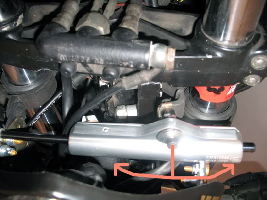

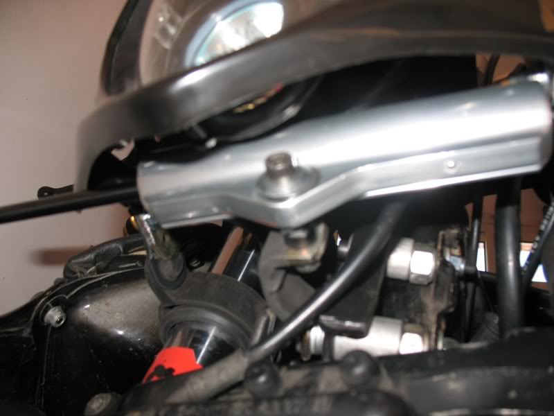

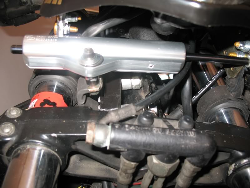

Sorry for the late
these are the photo of the damper's movement
i hope this help
i hope this help
- IMG_0213.jpg (46.49 KiB) Viewed 1922 times
- IMG_0214.jpg (61.28 KiB) Viewed 1922 times

so this is where it turns ?

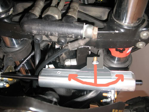

I would have done it this way:
Sorry, I`m no Photoshop artist

It does appear that the swivel joint has the range of motion needed. Yes the bolt in the vertical position would have been more like the stock install. This part is not structural so it look to be ok.

the vertical pivot bolt would be nicer.
spherical bearings are strongest and will last longer in load applications in the central axis.
of course, a steering damper sees 99.9% of it's time in the "straight ahead" position; you're in trouble if you have the steering at lock at any speed - unless you're into controlled power-slides...
so long as the strength is there when the steering is central is all you really need for the damper to be effective.
you need to be able to turn lock to lock (which you appear to have)
and
you appear to have used the full travel of the damper.
happy riding.
