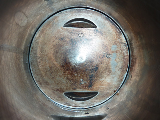

As I start to rebuild my 907 IE I want to get sure that the pistons are really in the right direction:
The are some marks on the piston:
S, A and B.
I suppose that B mens Belt side?
A is intake side?
B is exhaust side?
Thanks for your help.

the manual states the small indentation on the piston is the exhaust side.
Re: Fuel Pump
Thanks- but I have no small indication; just "A" on intake (?) side, "S" on exhaust (?) side, and "B" for belt (?) side.
Maybe its an italien shortcut ?; "A" for Accesso ?,...
Unfortunately there is no description in the workshop manual...

"indentation" not "indication". (die Ventiltasche im Kolben ist auf der Auslassseite kleiner weil das Auslassventil kleiner ist als das Einlassventil).
The smaller pocket on the piston is on the exit side as the exhaust valve is smaller than the inlet valve.

Like Nojapan said above, the letter codes stamped on the piston are suppose to match the material letter code on the cylinder. The other letters are the first letters of the Italian words for intake and exhaust. (If you download the shop manual from this site you can read the various languages for the piston section and you can figure out what Italian words match you languge, etc.) The orginal pistons had the same sized indentions for the exhaust and intake valves while the newer replacement pistons have different sized indentions for the exhaust and intake valves. S is exhaust and A is intake. See the picture below of the rear piston and cylinder.

OK, so S= scarico (exhaust), and A= aspirazione or accesso (inlet) and B means type of piston
Perfect
The indentation of A is only somewhat bigger (0,5mm) than S.
