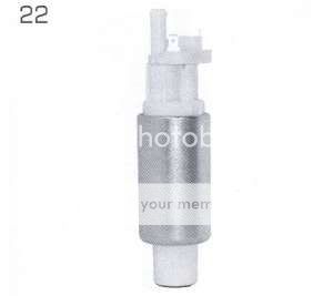

My fuelpump (907-1991) Marelli PI-022 was stucking- when connecting power nothing happend (even no short circuit). After some "helps" with air pressure & bumps (i got it out of the tank) it moved again- sometimes doing some strange noises! I ordered a new one- but unfortenuatelly it wasn´t the original Marelli but a Wabco pump with a different outer diameter :neener: - but with the right box (Marelli PI-022). Had everyone of you have probs with the pump?
Does anyone know how to mount the Wabco pump-? the original fuelfilter does not fit to the Wabco pump :screwy:

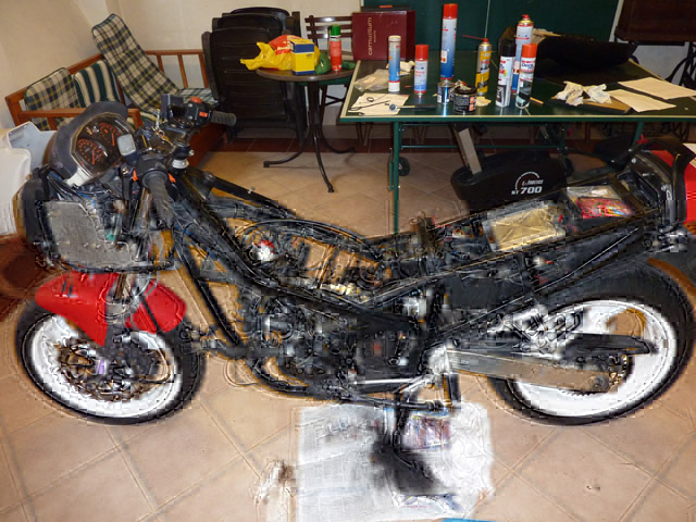

I made some pictures just to show you the present condition of the bike.
Today I got the overhoulded heads, the mec. meant that all the copper "studs" on the head are only for the collant- not for sealingthe oilroutes- can you confirm (I still wonder where the oil leakage next to the exhausts comes from, caus the sealing rings where new, and fastened with silicon..)?
What happened so far:
-new seat cover (selfmade- seciond time, got stiffness in my fingercups!)
-new petrol pipes
-cleaning of all plugs with contact cleaner
-new chain and sprockets
- repair of collant tank (second tank already, first try)
- many many small things to repair and adopt
and cleaning, cleaning, cleaning
still to come:
"new" tank with "kreem weiss" coating (I will post a picture of the perforated tank soon)
"new" fuelpump
new filter
Bodywork to be revarnished completely (decals already here)- RED rules!

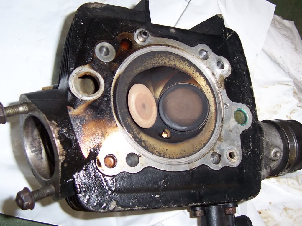

G'day Gernot,ynot wrote:Another question occurs as I stripped down the Cylinder heads (and the rest):
I always had trouble with small oil leaks coming from the Head (or cylinder) where the exhaust is located. I thought it comes from the copper stuffs (?) which are pressed into the head/ cylinder, but my mechanic says this is only to seal up the water-coolant.
I already changed the rubber rings twice, but after some time still it leaks a little bit.![]()
Does it come only from the rubber rings, or does it come from the (smaller) copper "thingis"
I will send some photos soon..
Thanks
Gernot
Your mechanic is right, the plugs are there to seal up the coolant gallery. Have you checked your heads to see if they have warped.
This is a photo of nnnnnnnnnnnnnorman's head, you can clearly see where the head has warped adjacent to the exhaust port/valve. It may be that its unburnt fuel mixed with carbon deposits leaking out rather than oil??? If you could post some pictures it would help.

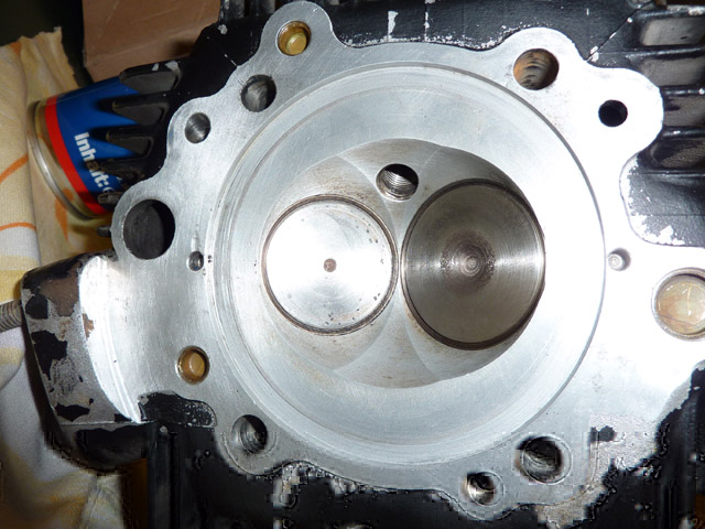

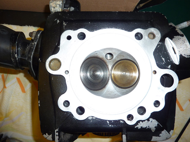

Re: Fuel Pump
Hello!
I was quite sure that it was oil, it even had a light colour (fresh oil).
The mecanic ment, that it only can come from the sealing o- rings.
The pictures are from the already overhoulded heads.
Before there were no similar deposits as on your head (cylinder area).

http://www.merlinmotorsport.co.uk/produ ... rrency=USD
The Weber fuel pump for DUCATI ( Motorcycles) 907ie (Weber PI-022) 139.34(GBP) 164.60(eur) 222.30(USD) 221.55(AUD) 288.40(NZD)

Could you please tell EXACTLY what is done to these heads.The pictures are from the already overhoulded heads.
If this machining stops exhaust leak it would be VERY good to know!
Re: Fuel Pump
In fact nothing than cleaning and valve adjusting...
As the copper studs are not responsible for the oil leaking I think that the sealing rings are the bad guys- I just wonder if and why...
I´m afraid the merlin pump is the Walbro thing which doesn´t fit 1:1 because of smaller diameter.
So filter and rubberhose does not fit...
I have a new one at home, anyone interested?
