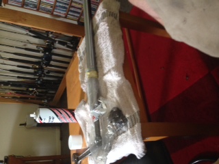

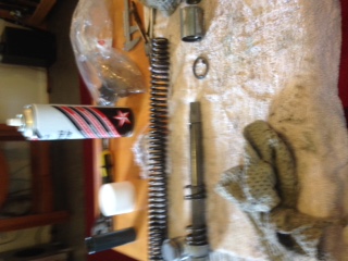

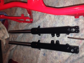

Next up the Forks
Sliders blasted & painted
Stanchions were straight but just started to bubble ... soooo in with some new ones to go with Bushes, seals, etc
Easy enough job
Easy enough job
- Reassembly.jpg (37.57 KiB) Viewed 16611 times
- Old Stanchion & bits in the bag.jpg (34.32 KiB) Viewed 16611 times

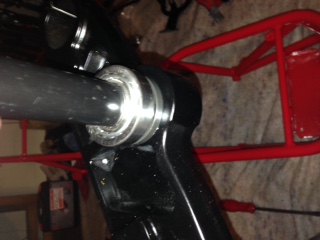

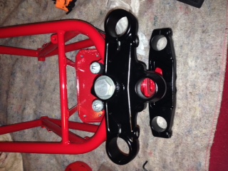

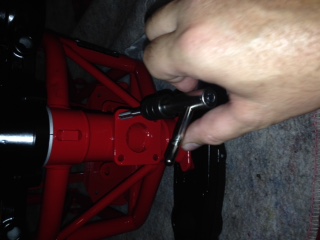

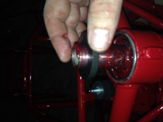

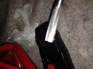

The Triple
Same pretty simple ... new bearings in after packing
- Press Fitted Bottom Triple.jpg (29.93 KiB) Viewed 16611 times
- Installing Spacer.jpg (23.1 KiB) Viewed 16611 times
- Triple Installed.jpg (43.95 KiB) Viewed 16611 times

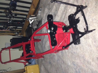

Re: 90 900 Supersport Tidy-up
Fairing Frame blasted & painted
Clear out the thread
Starting to put some of the work already done on to the frame ... starts to look like a machine
- The Thread.jpg (27.36 KiB) Viewed 16611 times
- Debris.jpg (33.7 KiB) Viewed 16611 times
- Frame Installed.jpg (44.25 KiB) Viewed 16611 times

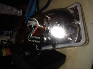

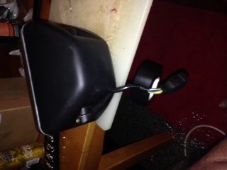

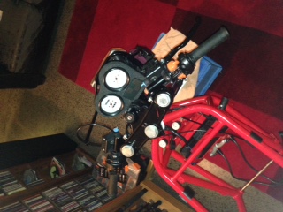

The Dash & the Headlight
She was smashed ... previous owner had run into the back of a truck with an overhanging load
What you see is what was under the black tape holding the gauges together & a replacement Headlight
Couldnt save any of that so in to search mode for replacement
On the Headlight I mixed & matched a replacement headlight with what I had
Some of the reflector has sh!t itself on the new HL which really p!sses me off as that wrecker has consistently sold wrecked bits at top dollar but consistently sent up crap - bought a rear light that was broken in the exact same spot as the one I needed to replace... the clip ons were good for nothing when I got ... & the airbox I bought is missing clips/bungs & the seat that sits in the carbs is deformed (I will take that up with them soon to be fair)
In with new bulb & T10 LED ... the right grease & back together
On the Dash sourced parts & in to the fairing frame
After reading various on LED's I am going to pop some T5's in the Dash Lights (have sourced coloured LEDs from China for about a coffee in cost)
- In with new bulb & T10 for parking light.jpg (25.14 KiB) Viewed 16588 times
- Completed Headlight.jpg (26.27 KiB) Viewed 16588 times
Last edited by The Paua Poacher on Thu Jun 11, 2015 5:56 am, edited 1 time in total.

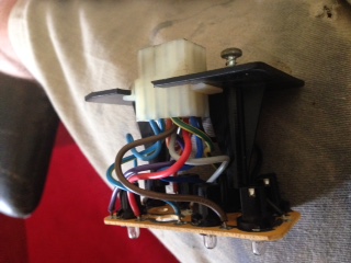

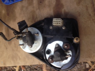

Dash Photos
mmmmmmmmmmm VEGLIA (hope I spelkled that right)
When installing I replaced all the rubber, bolts, etc, etc at same time (thats not the expensive bits)

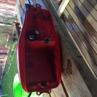

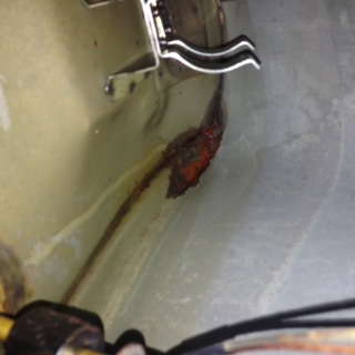

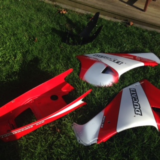

Tank
While I wait for the Primary Drive to come back so the cases can come back together I started thinking about her clothes
As mentioned this has been down the road ... old owner hit overhanging truck load so the fairing frame took the brunt of the ding (damages were all consistent with that)
The front fairing on the machine I had was fibreglass so found a replacement ... still needs a major sand, glue & ground up paint
I haven't taken photo's of the fine stress cracks (there were only a couple) ... or the half ars$d repairs behind the fairings (all done before) but have shown the tank has been caught in time with only a bit of rust in one corner & not terminal (great)
I wont do this work as the tank needs a paint strip... repair weld the rear mount ...a little panelbeating ... reseal & full paint ... but is underway while I work on other bits
Question ... anyone have a fuel sender (would consider a pump as well) they are happy to move on? ... please PM
Need a Seat Cowl as well?
- The Fairings.JPG (58.56 KiB) Viewed 16554 times
- Tank Rust just started.JPG (30.02 KiB) Viewed 16554 times
- Bottom of Tank.JPG (48.27 KiB) Viewed 16554 times
