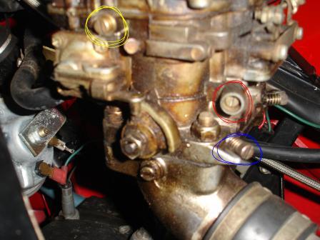

Try cleaning the idle jets first, and run the bike for a while after the cleaning. The idle jets, being so small, tend to gum up when the bike has been sitting for a while. If that doesn't seem to help then adjust the idle mixture on both cylinders. I know that my bike can be sensitive to idle adjustment, with similar symptoms to what you describe, if the idle mixture screw is off by even 1/2 turn on one cylinder.
For reference, the idle jets are held by the screw-in carriers circled in yellow in the attached photo and the idle mixture adjustment screws are the ones circled in blue (sorry for the crappy picture quality!).
While you have the idle jets out of the carb, spray some carb cleaner through the open passages in the carb.
Also make sure that the air bypass screws are closed (circled in red), if one is open too far it may also have an effect on idle operation.

Sorry, forgot to point out that the vacuum gauge lines should be connected to the ports on each side of the carburetor, just above the outlet manifold. In the picture from the post above, one of the ports (and the blocking screw) can be seen just below the accelerator pump cam. The other one is in the same relative position on the other side of the carb.
