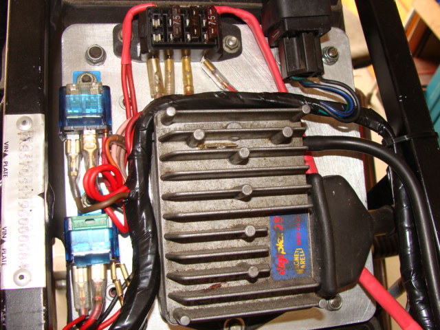

Posts: 2033
Re: 750 Weber woes - same same but different?
Is there a return fuel line back to the tank from the carb , or a pressure regulator . The fuel pump can overpower the float valve ,and as you describe leaking and black plugs .... sounds rich . My paso has Tee in the fuel line just before it enters the carb and just goes back to the tank return , some run a diaphragm pump off the Monster and some have a fuel pressure reg .
As Higgy and paso750 have said the electrics can ( and often do ) play up , nothing hi tech just switches and connectors that wernt great in the 1st place and are now suffering a bit of age as well , easily fixed/ improved .... heaps of posts on that . Adding a main relay goes a long way to sorting it.

in my opinion check your electrics and also check your filter,clogged filters are the root cause of many Paso ills as they make the pumps work harder and put more stress on the entire so so to begin with wiring/charging system :idea: :idea: :idea:
I`d also replace the NGK spark plugs for Champion RA6HC. For some reason most Pasos run a lot better with them.
What you will possibly find when measuring the voltage at the coils is that instead of 12V at idle there will be only 9-10V. With that voltage the coils can barely do their job and sometimes one won`t create a spark at all.
