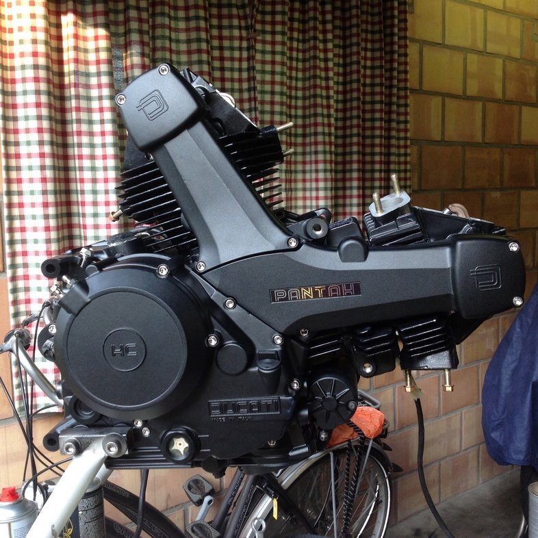

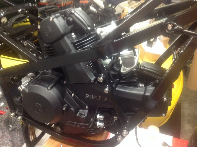

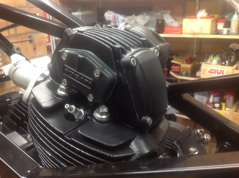

Re: Oil leaks 89 900 ss
Mine I painted with VHT engine paint and the lids were powdercoated (black relief) ...
Wish I could upload higher res. (Now max is 1024/786).
No, didn't file of the raised lettering, I like it black and discrete.
Just ordered a new sticker (Australia) and used electro polished stainless steel bolts and (cylinder) nuts, which shine almost like chromed.
The top lids (valve covers) are a cheap alu/zinc alloy and were a bit corroded so I decided to make them mat black so it doesn't stand out.
All steel items are re-galvanized.
Main goal was to get a "like new" engine (I have overhauled the engine; new clutch and clutch mechanism, new gaskets, bearings and seals, complete cylinder heads overhauled) but no frills, just a taut engine.
I'm trying to improve the look of the Paso with the fairing removed (small changes), with improved brackets for coils, fuel pump (vacuum), new (black) Aeroquip oil lines, new polished stainless steel fasteners, improved cabling etc.
