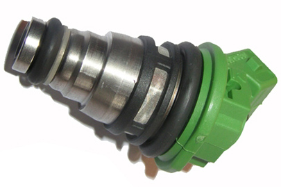

As far as I know there is a fuel strainer at the pump inlet to keep the big bits out and an inline filter on the pump outlet for the fine stuff. Some injection systems have tiny filters at the inlet to each injector but as far as I'm aware Ducatis with Marelli injection don't have these.

You are RIGHT Derek where thay all are. Marelli injectors have them ALSO in each injector inlets. That company where i have maintained my (ab. 10-12 injectors) told to me that that there ARE very small filters and need SPECIAL TOOL to take them out and clean and put back. Cant do that in home without such tool.Derek wrote:Four filters? You had better enlighten us then Antti.Finnpaso wrote:Higgy, there is NO "ONE fuel filter in 907", as there are 3 of them, ....if thinking EXACTLY, 4 (!!!!)

Well, well. I didn't know about these but was aware of them on other injection systems.Finnpaso wrote:You are RIGHT Derek where thay all are. Marelli injectors have them ALSO in each injector inlets. That company where i have maintained my (ab. 10-12 injectors) told to me that that there ARE very small filters and need SPECIAL TOOL to take them out and clean and put back. Cant do that in home without such tool.Derek wrote:Four filters? You had better enlighten us then Antti.Finnpaso wrote:Higgy, there is NO "ONE fuel filter in 907", as there are 3 of them, ....if thinking EXACTLY, 4 (!!!!)

An acquaintance with a Suzuki 1200 Bandit was having problems at higher speeds. The bike behaved like it wasn't getting enough fuel. He had had it to Suzuki dealer and a major service was done yet it still ran poorly. After a lot of internet searching he eventually found out about the filters in the injectors. He got them cleaned and the bike ran perfectly again. The dealer didn't even know about them.
Which makes me think. I've been working with injected Ducatis for about 20 years now and I've never seen any mention of these filters. They aren't mentioned in any service manual that I've ever seen - 907, 851,916, 996, 999, ST2/3/4, MTS1000, MTS1200, MS4, MS4R(S), 1098 etc. As far as Ducati are concerned the injectors are not a serviceable item and I suspect that very few technicians even know of the presence of the filters.

The IW724 injectors of the ST3/4/748/916 etc have the filter as a ring on the outside as can be seen on the picture below.
The IW031 of the 907IE (which is also used on the Lambo Diablo and others) has it inside.
Some shops sell revision kits with filters and o-rings or just the filters. I.e. https://mrinjectoruk.co.uk/Fuel-injecto ... 26298.aspx
No idea if these would fit the 907IE injectors. One would have to ask.
I don't know anything about this, these are just some Google results
