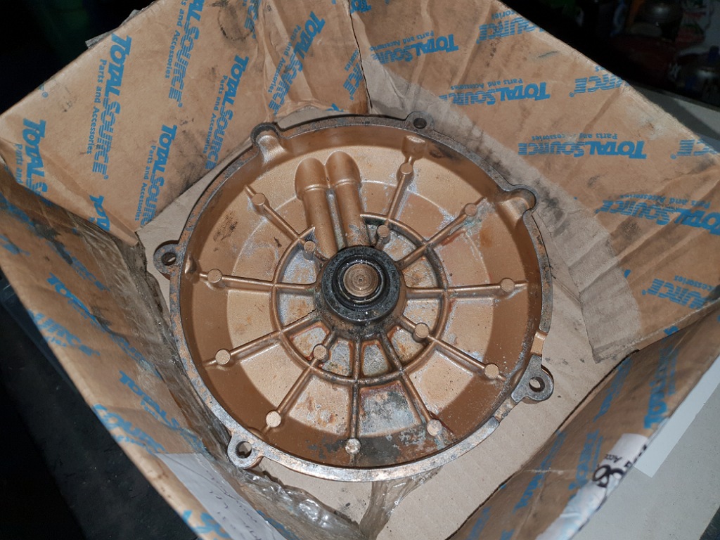

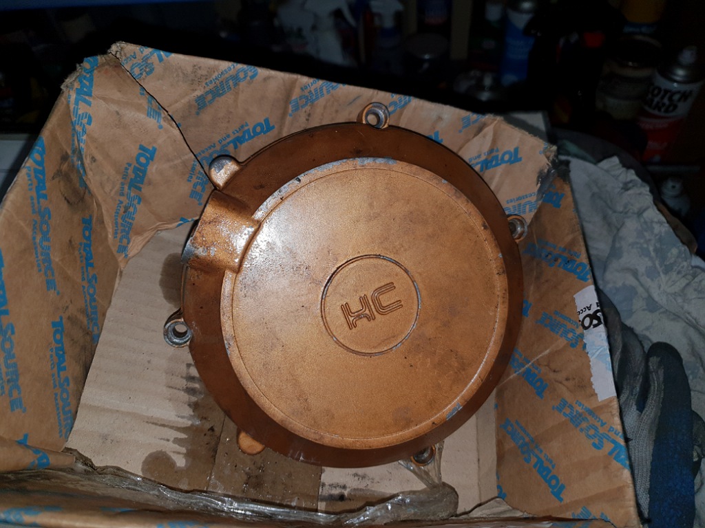

I just opened the package from Rudy, looks sweet, tomorrow I have a go at checking out the slave piston, once again from Rudy always good parts and no mucking around

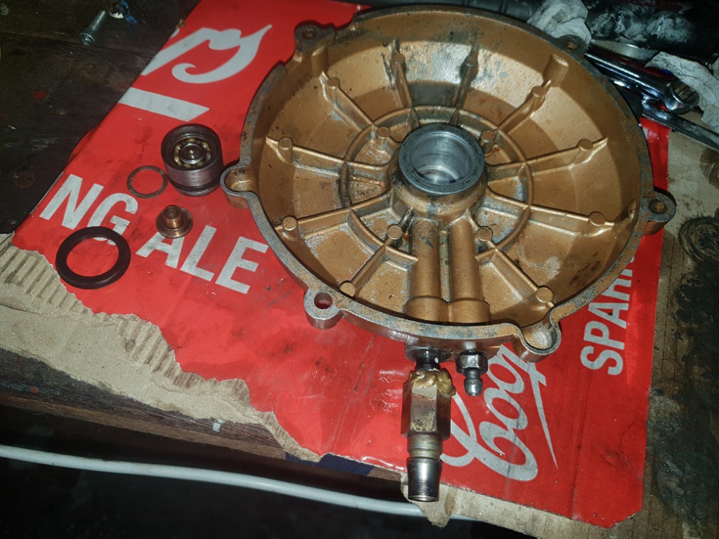

And again the piston was quite stuck in the bore, air alone didn't work air and a rubber persuader didn't work but the added gentle heat on the boss released it in a big hurry, lucky I caught it in the guts not the head
Re: brake/clutch fluid resistant paint
Posted: Sat May 30, 2020 10:46 am
by HIGHWAY89
The bore looks good and the piston looks good, a new seal and a grease should be all it needs, l think this unit cant be stripped any more than what you see and this is different to the piston I have in the 900 but basically same, I think Rudy said this is off a paso
