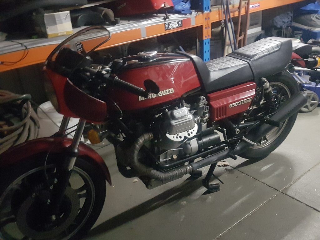

That's no worries mate , hopefully helps someone, this thread is gunna go from oil leak to finish of resto , just chucking one photo of the 78 up here

I love the Guzzi Lemans. I had a choice between my MHR900 and a MK111 Lemans in '84. They were both side by side in the showroom and the one deciding factor was the Guzzi was white and I wanted a red one. I still have the MHR.
HIGHWAY89
Posts: 637
Re: Oil leaks 89 900 ss
Post by HIGHWAY89 »
Nice bike the mhr 900 I rode one years ago when I had my lemans 3 and loved it

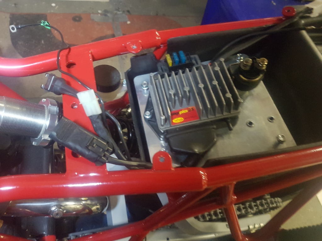

Still playing around with cases painting and wait on a clutch seal so I started cleaning and befitting some electrics , keen to start fitting the refurbed harness

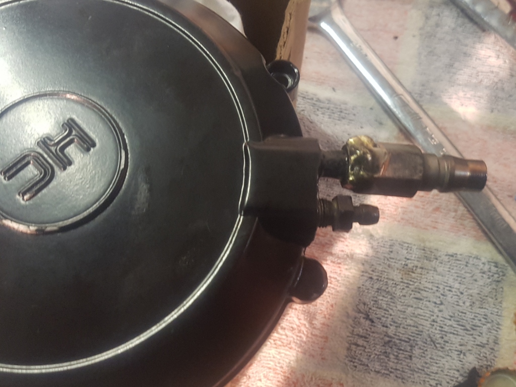

This is how I hooked the compressor to clutch cover to help release the slave piston, drilled a hole through the top of banjo and bronzed nitto to that
