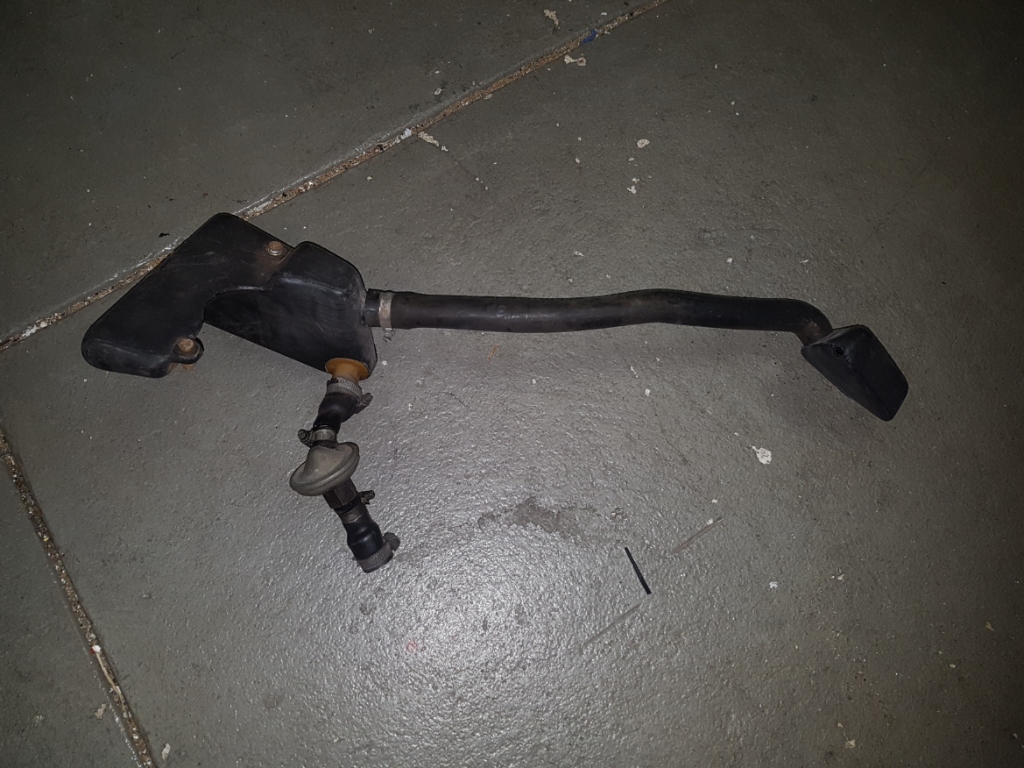

iThanks for explaining that one , I guess they would make it simple if it worked, I will keep it pretty original there, heres a pic of mine , ill start with a good cleanup

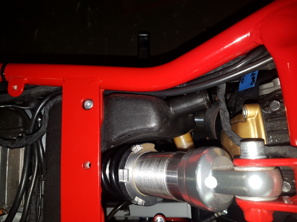

Clean and refit the breather tank and with the new hagon shock I have clearance of 2 sheets of a4 paper so pretty tight but should be fine, all the rubber hoses are perished and the 2 short reducing ones may prove hard to replace

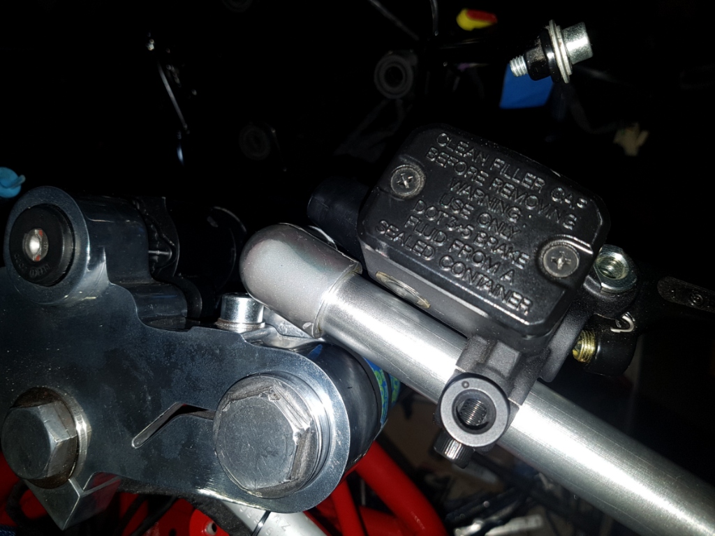

Just remembered why I didn't stick with the tomasellis, the adjustle knuckle blocks the brake reservoir sliding up the bar enough to work without a 4 or 5 mm spacer, I was happy with nos original clipons anyway so all good, oh well it beats watching tv , moving forward slowly

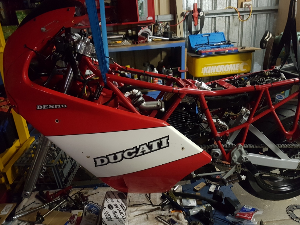

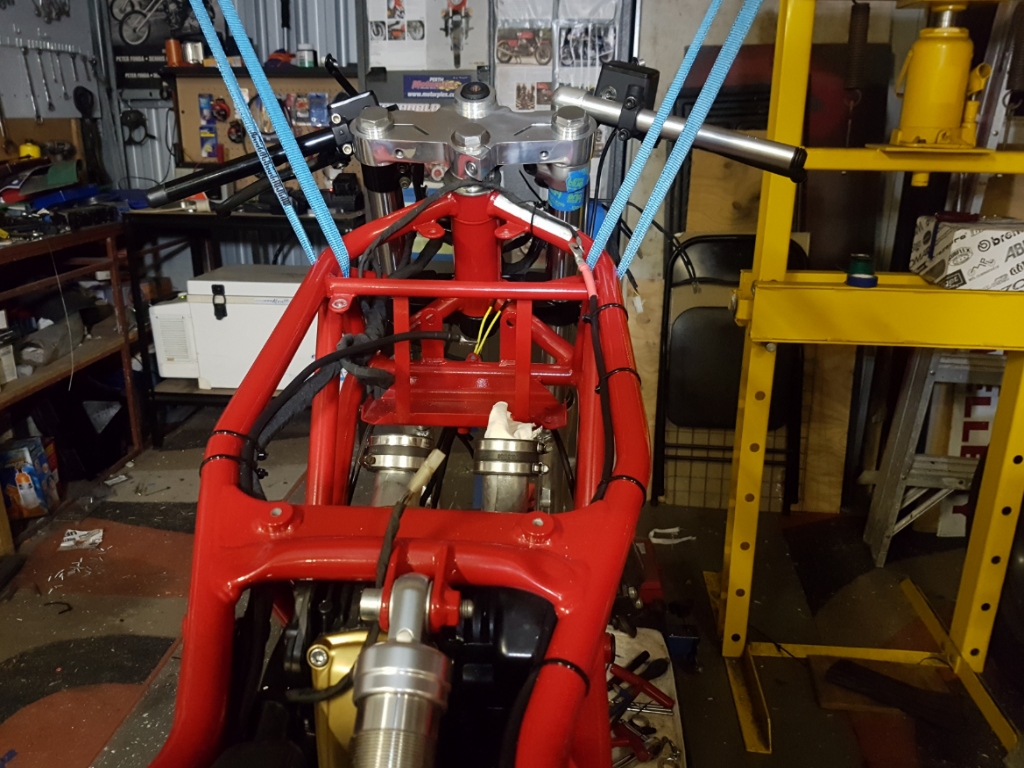

If all goes well the bars will sit near to this latest pic but in saying that I must setting adjustable bars up on these are pretty tricky

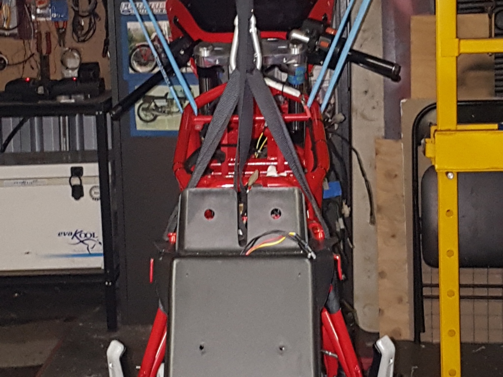

The more I look at this I realise how much goes into seeing if the tomasellis will fit I realise that I really need to set the lower fairing in place as Well , I wish I had of kept at it the first time, but it should be worth the effort

I'm only concerned with the throttle side as I've upped the size of the brake reservoir , the other side will work no woz

Are there any stops for steering sideways movement?
Re: Oil leaks 89 900 ss
Posted: Mon May 14, 2018 11:57 am
by HIGHWAY89
I think the bolts for brake lever will be like stops if I Don't drop down lower to clear triple tree but that will all but defeat the purpose

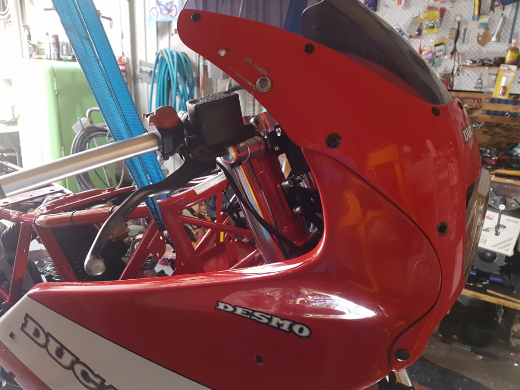

Posted: Sun May 27, 2018 11:22 am
by HIGHWAY89
Not a lots changed but I degreaser and cleaned the fairings and setting them up to see how these toma's are going to work, got the spacers so just gotta sort it out and move on
Posted: Sun Jun 03, 2018 4:05 am
by HIGHWAY89
Verdict is in I'm farkin over it the tomasellis will not work on these bikes !!! I'd like to be proven wrong but I just can't see it , I've even tried them with the stock brake reservoir and no go, can get the res to clear but still hitting fairing to brake lever, lots of work ANF frustration but atleast I know now, I'm sure I could get them to function but there'd be no advantage
