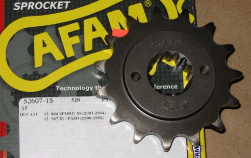

AFAM part number for a 907 front sprocket (15 tooth) is 52607. Not too hard to find, I ordered one tonight. Google it and take your pick of vendors.
Now... how well it will fit remains to be seen.

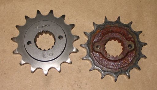

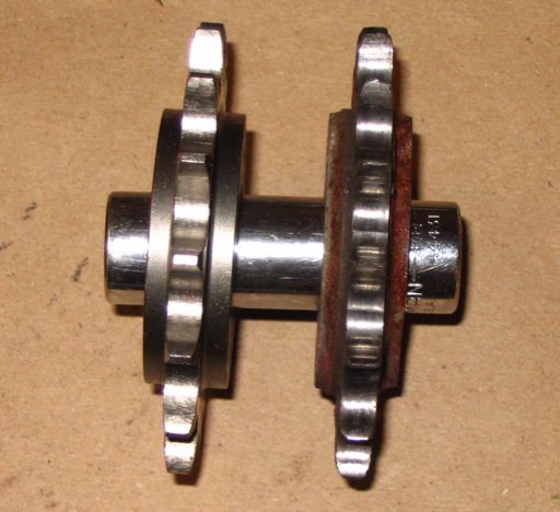

I finally got around to installing the new front sprocket today. It is approx. .005" (0.1mm) narrower than the original, which is close enough for me! The packaging says it also fits the 2003-2004 800SS. It looks wider in the pictures, but that's just an illusion.
Here are some pictures for people who don't trust anyone... (you know who you are!)
-Craig

Looks like it was definately time to change that sprocket out!!!! :eek:

Stingray230SX wrote:Looks like it was definately time to change that sprocket out!!!! :eek:
Yeah, I was pretty shocked to see it was that worn. Neeedless to say, once I pulled off the cover and saw that, I knew it was time for a new chain and sprockets, no question... ok, so maybe it was way past time for new one!

M900 carb 1993-99 front sprocket does not fit, tried today.
M900IE 00-02 had another sprocket, due to 748 gearbox w longer gear shaft.
The thing that matters is distance between toothed washer and centre of sprocket. If that is correct, it aligns and all is OK, no matter what the sprocket looks like. If done w a washer, no problemo.
