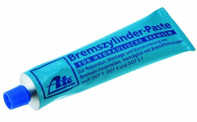

For assembly I meanwile use ATE brake master cylinder grease (ATE 03990205012). Not (!) to be mistaken with the brake caliper lubricant that is applied on the back of brake pads or on brake caliper pins. The master cylinder grease is a special grease which other than caliper grease is used on pistons and rubber seals and which does not react with brake fluid.
data sheet:
https://app.box.com/s/ognks2mehubw6261825r0wr0ent04my7

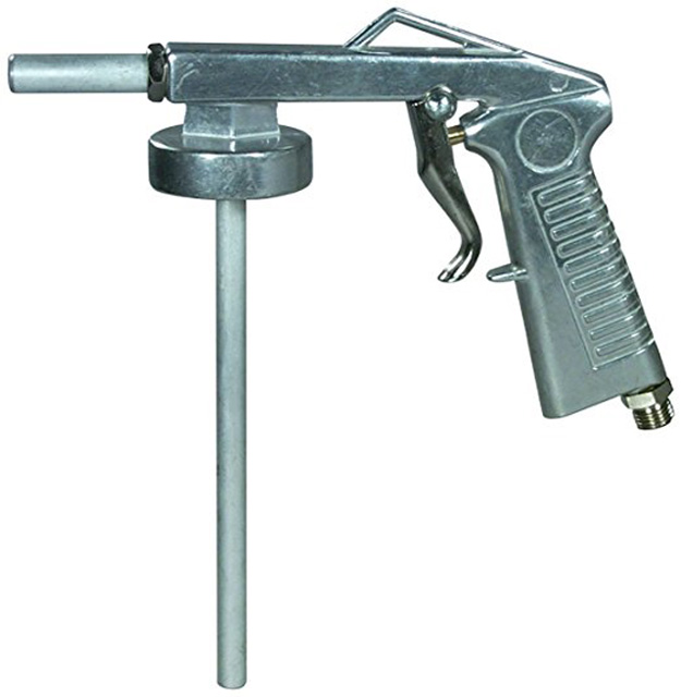

In the past I've used an undercoat gun to bleed brakes or the clutch if it didn`t work the 'normal' way. Not a subtle or really recommended way to do it but it worked for me. I attached a hose to the bottom tube and via a reducing piece a thinner hose that would fit on the bleed nipple. Pull the trigger then open the bleed screw. One needs to be sensible when operating this setup otherwise brake fluid will be sprayed all over. Also it should not be done in the garage or with a car standing nearby. At least not if you`ve never done it this way before
