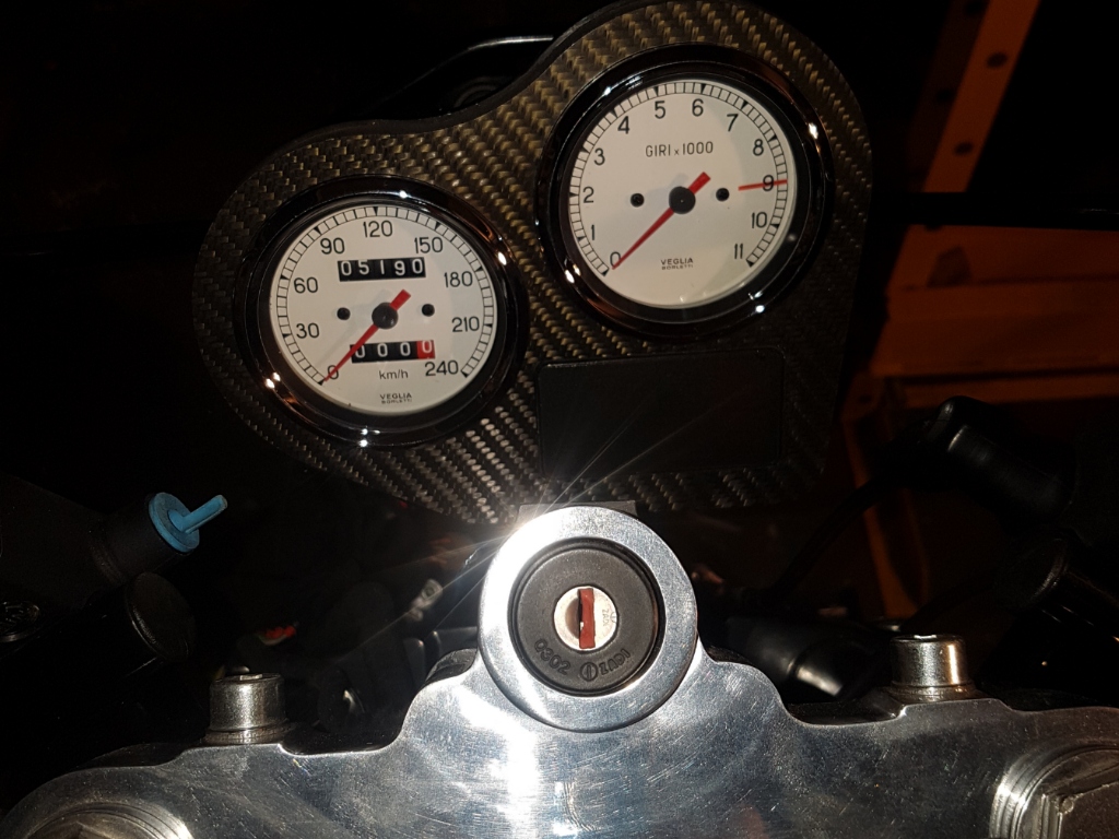

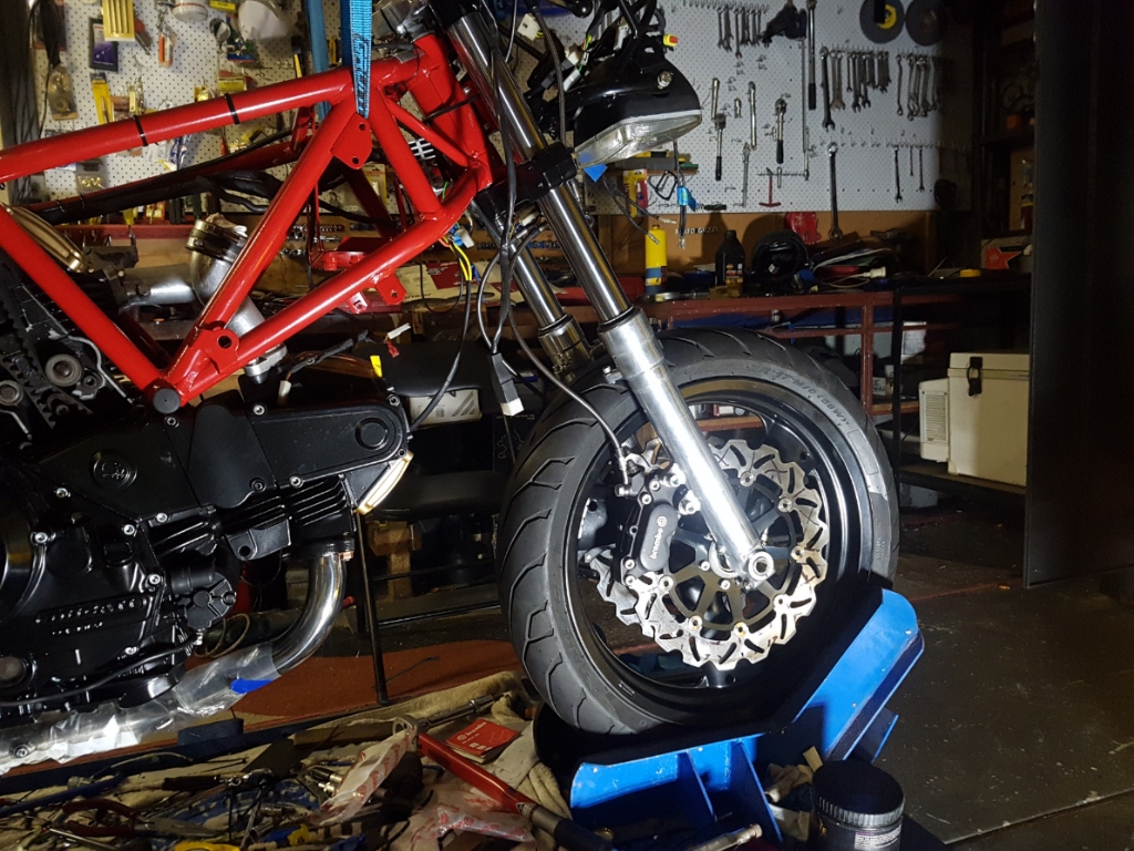

Speedo and rev counter in for a quote to restore / glass and bezel , fingers crossed for a good price and job, frt wheel and brakes back on and the left disc bolts countersink 3mm, so she's progressing but slowly

No good at instrument shop , anyway I've ordered some chrome bezels / glass cheap and get shop to crimp if they're right. Got a longer stand and finally paint and put together with replated springs etc, waiting on the bezels, also ebay a restorable condition rear lens and housing as mine knackered, and nos Speedo drive turned up with a split in the housing same as mine , but not ground down like mine and it clears the countersunk rotor screws, so goodo

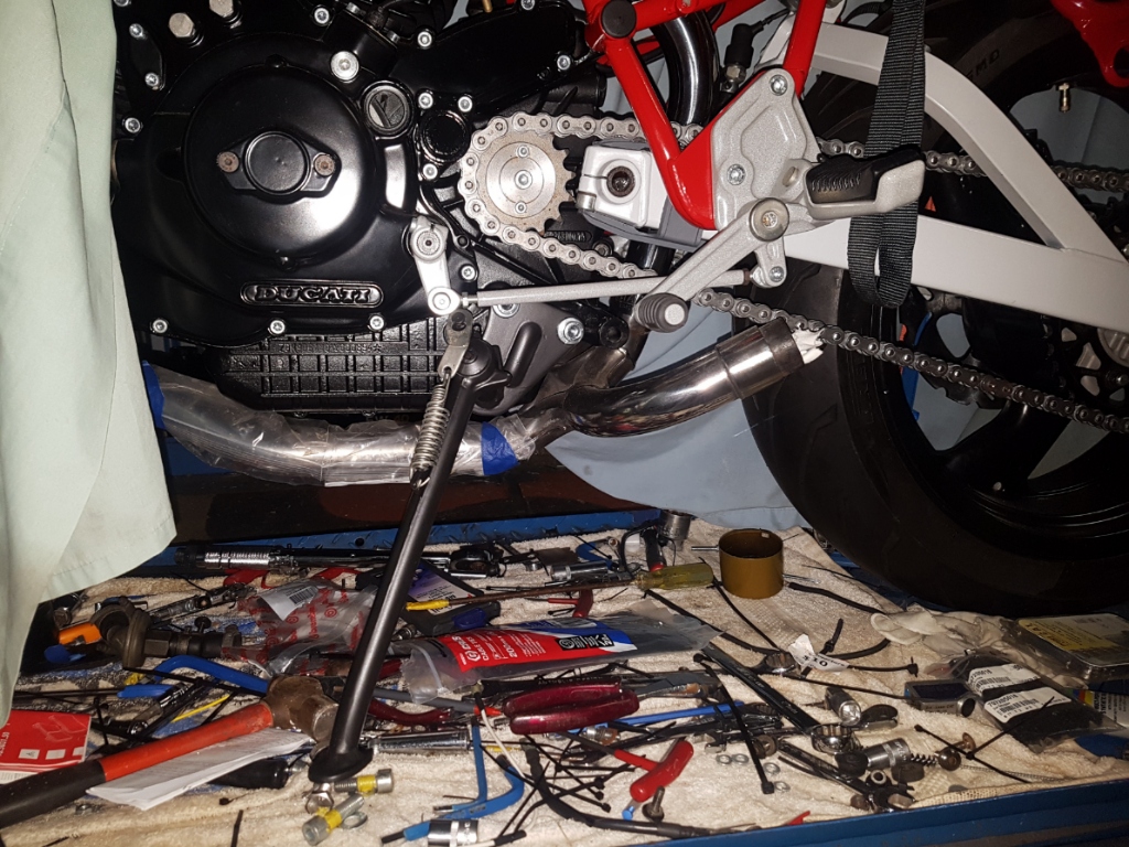

by MatthiB
Still doing an excellent job! :thumbup:
May I ask where you took the longer sidestand from and what sprocket fixation bit that is?
Thanks for that and for letting us follow you work!

To be honest I don't know which model the sidestand is off , when I got from ebay I thought it was the same as original but it turned up being longer which is great although I haven't had the bike on the ground yet to check, the cap on the end of the countershaft was made by protwin ducati to compensate for a slightly worn spline so I didn't split the engine and replace the shaft

It looks like the stand from a 907 but I guess there are a number of other possibles.
