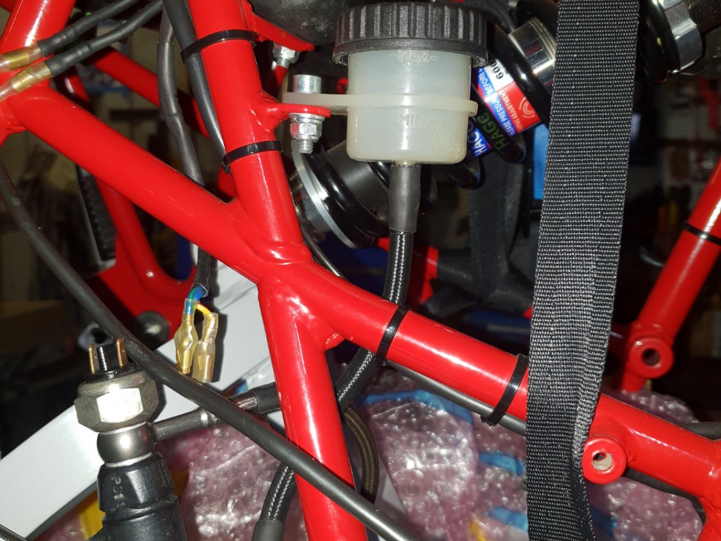

Posted: Fri Jul 31, 2020 1:20 pm
by HIGHWAY89
I have the engine off to justin on Monday so things are starting to move again , although standing here looking at it and it just seems like I've gone back so far, the hose between the rear res and the rear master cylinder was sweating so that's all off but pretty keen again because I originally didn't see a engine rebuild and now she'll be all tickety boo, this will inspire me to pull my finger out and crack on with the painting

by HIGHWAY89
I finally aquired some brake fluid compatible hose for the rear reservoir to master , I went to so many businesses to find it and lucky last , perth brake parts, engine strip next tuesday
