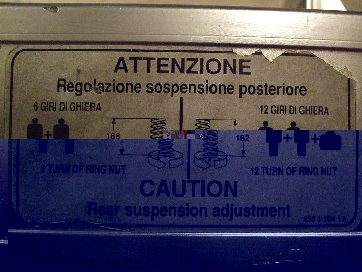

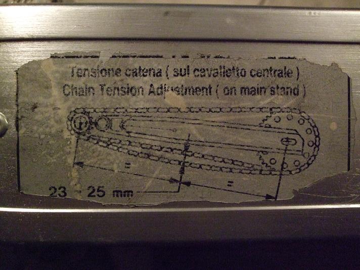

Hi Guys,
can someone of you make perfect pictures of the swingarm decals?
I want to reproduce them, and digitally restoring mine would be lots of work...

- Posts: 5570
Re: Rebuilding my 907 ST3
Johannes, if you get a set made, get me one, too please.
The first one looks very similar to the one of the 851/888 (#43311051A) it only says 25-27mm instead of 23-25mm. This one may still be available from Ducati.
(Have you asked Ducati for the other one #43311041a ?)
