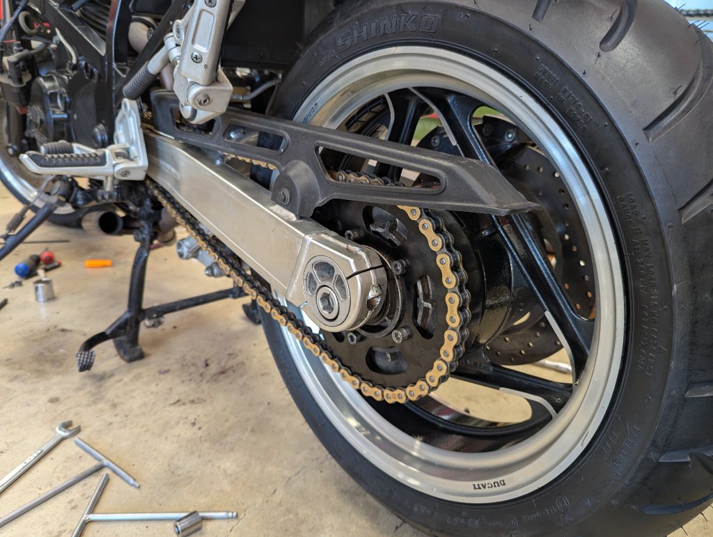

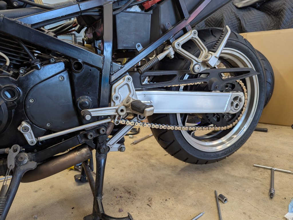

Life happens so I had some time away from this. Just threw a new chain and 40t rear sprocket on. Haven't set the tension yet but at least got it on.

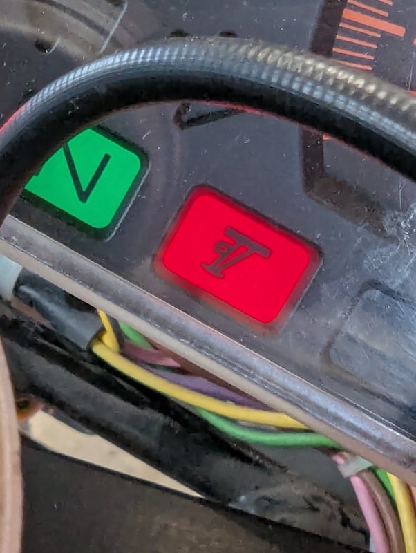

Went out to start the bike and it had a hell of a time starting. Also noticed this new dash icon showed up that I haven't seen before. Scouring through the manual is leading me to nowhere and finding a lot of old broken picture links. Gonna be a bit to see what's up now
