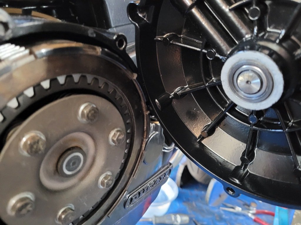

I have taken the clutch cover off and I can pull the lever, or at least pump the lever and yes the piston moves happily outwards and I can push it back in by hand, not sure what to do from here.

I'm starting to think that I neglected to refit the spring prior to fitting the piston in the cover! Could this be the reason for the clutch lever feeling like the brake lever? Now I need to hunt down the spring as I can't recall seeing that sucker anywhere anytime lately.

Start again. Try taking the master cylinder cover off and push the piston in as far as it will go. Watch that the fluid doesn't flow out of the master cylinder. If the piston bottoms out solidly and doesn't return a bit then you have probably left the spring out. If the spring is in there you will know well before it bottoms out. Or you could just pop the piston out and check for peace of mind. I think the spring is only to keep the piston firmly against the centre of the clutch.
Are you saying that you need to pump the lever to get the piston to move?.
