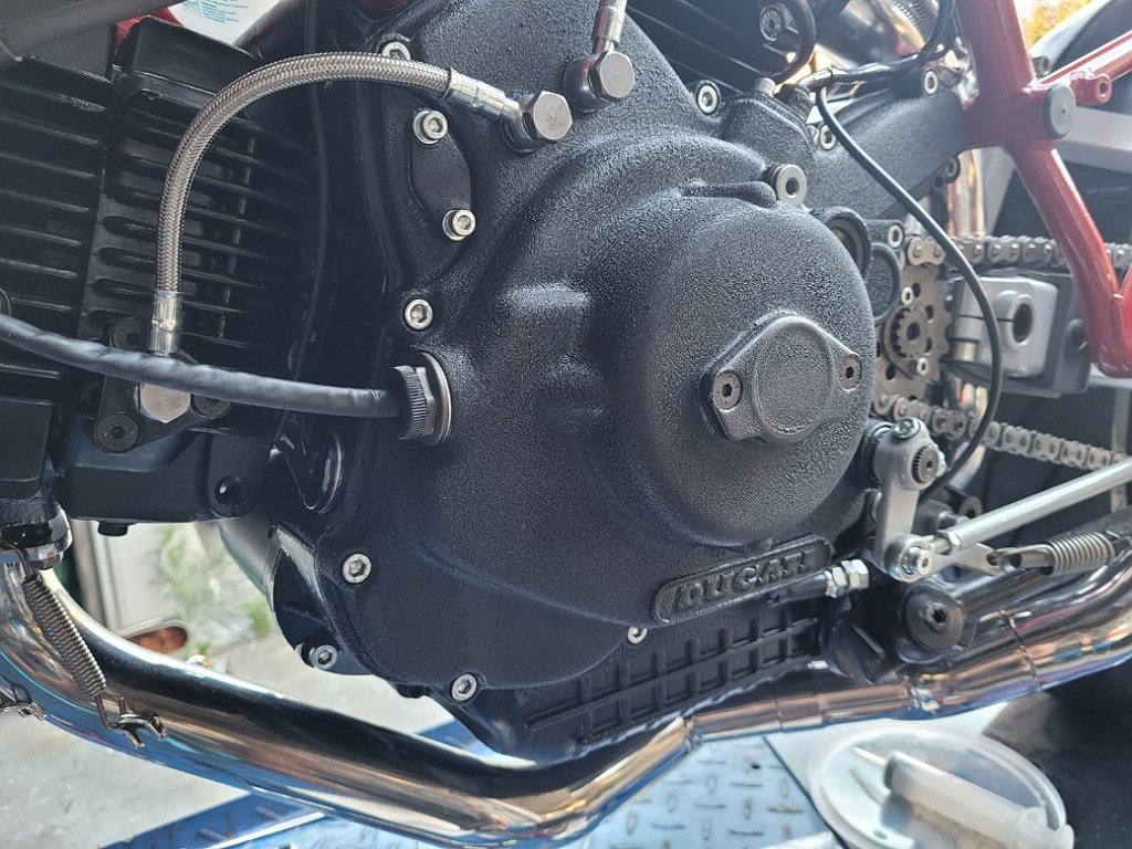

Well I fit the motobatt and hooked up all the cables, refit the filter and pump etc in the old tank and tried to fire her up, firstly without the plugs in to move some oil around. Next I tried with plugs in and no go, got spark but no fuel. I found oil spitting out from the alternator cover where the alt cables come out, I'm hoping that's because I have not siliconed up the gap around the exit there and cables. But I'm not even getting a dribble of fuel out the

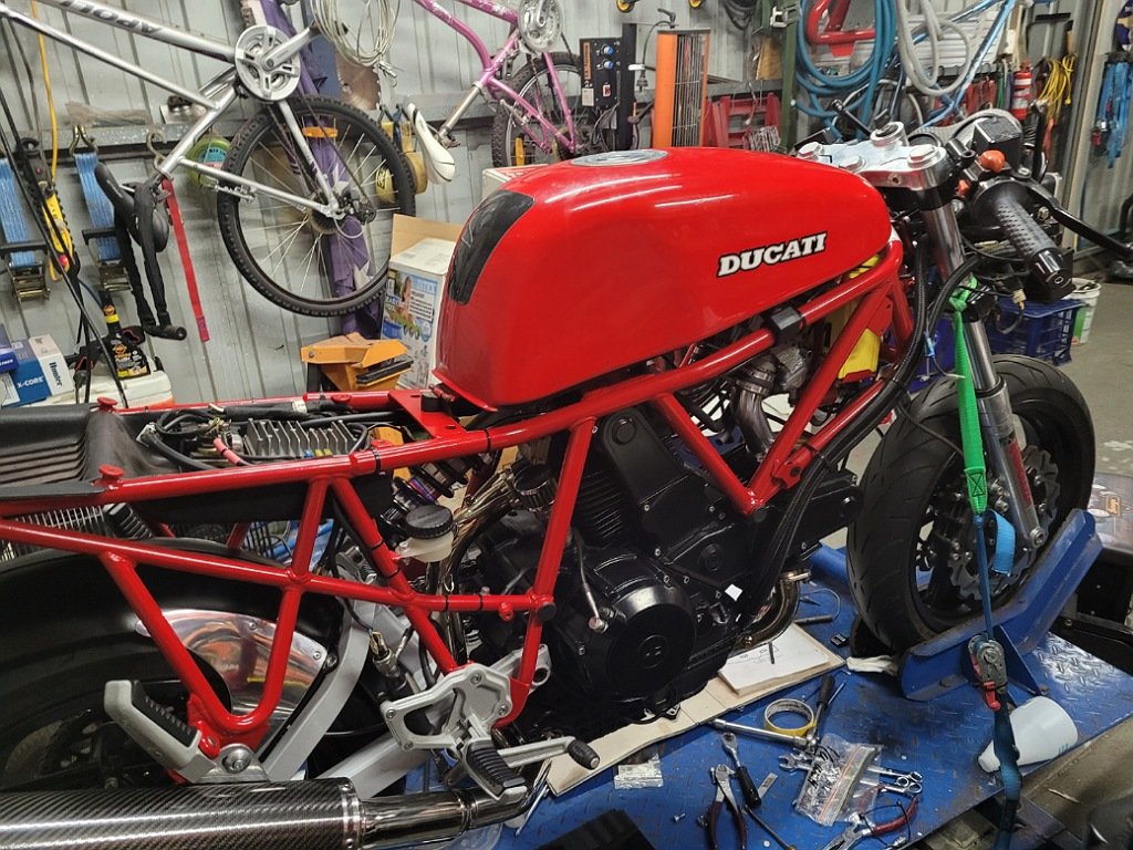

by HIGHWAY89
I think it was the wires back to front on the pump, I siphoned the fuel out , removed the pump and all .compressed air back to the spigot/tap, reversed the wires and checked the direction of inline filter. Yeah I refueled and fit fit the tank, give it a kick and she wants to go, trouble was I had a inferior three way connection on the lines. Well I definitely had fuel,new brass t piece and yippee yahoo, music to my ears she gave few little pops and then settled down to a liv ely tickover and a big roar with a bit of a twist, couple little issues but its a step closer, actually big day for me, pretty pumped

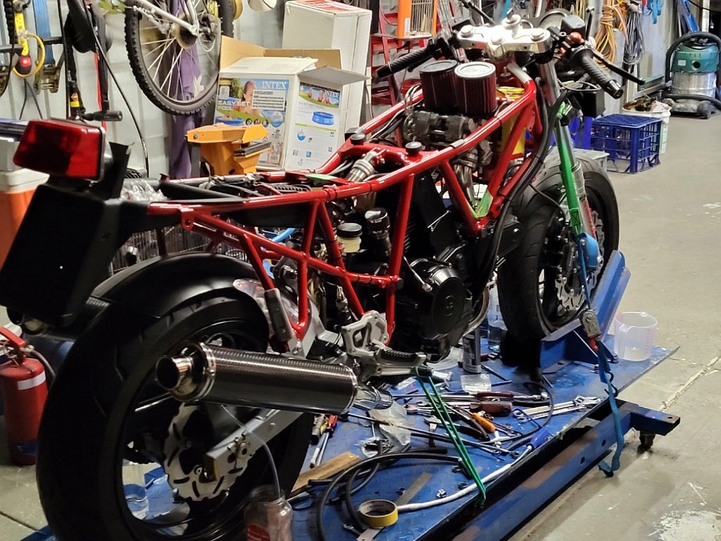

by HIGHWAY89
Having another look at the K & N f soup can filters i bought way back and decided to cut some of the rubber flange at an angle and popped them on, so far so good.
