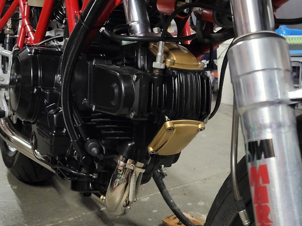

Mate, I tried looking into that but no luck. Nothing in any of my manuals and steinedinse seemed to have changed their format so no go there either. With my bike I don't need anything re the bent tray straps, keeps it pretty snug. Maybe some kinda foam wedged in there, I've never seen a proper factory fix.This pics not related just want to post it.

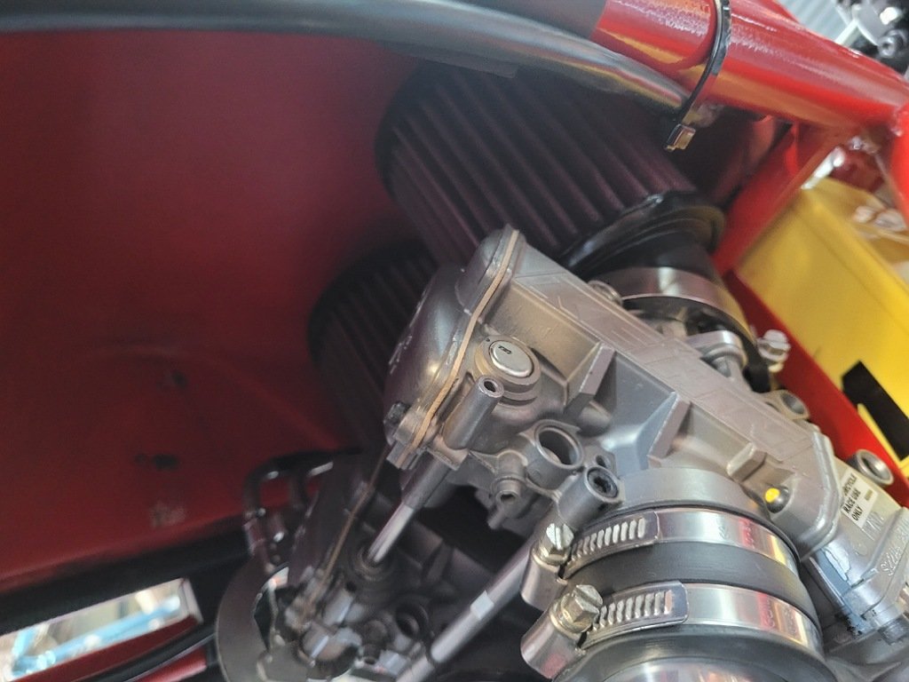

Here's a picture of the filters , it all seems to fit without any cutting of the frame. Contrary to what I just said, both battery straps need some bending and I remember a slight mod to the original coil brackets and the fcr 41's will fit this model, I think the inlet tracts and rubber connector are from the 91 on 900 ss that run mikunis as thats what mine had when I got her.

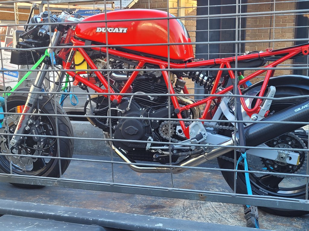

Well I got this far on Sunday then informed I had to isolate for a week due to a close contact at a party on Saturday. She was going to protwin on Monday so now that's all pushed back, and he's always busy so will need to rebook. Only silver lining was it was bloody good party. So close haha , I'll get there one day, life really does get in the way sometimes, weekends are often up the aged care facility where mum is hangin on and we brought dad over from Melbourne as he went downhill in a big hurry, divorced 40 yrs and now back together and happy as she can't remember him waha. Hope to start back on the painting soon.

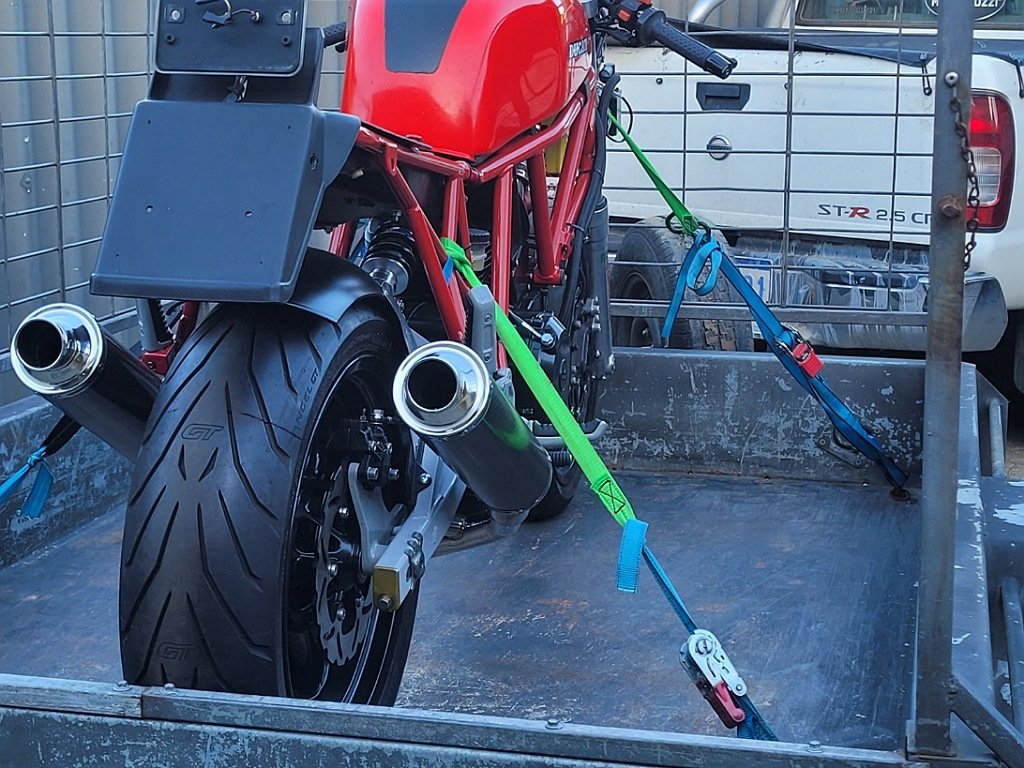

It's good you can catch up with your boy soon, we're just starting to get covid here, I tested pos yesterday so another week in iso.The bike is pretty clean and the spare tank is what's on it now, just for these last mechanical bits , hopefully Justin sorts the clutch without too much drama then I'll look at the painting again, I'm not sure about tank protectors at this stage, I should start painting but the idea was to get mechanical done first, now she's sitting out on the trailer for a while.i really need her up on my bench to fit the fairings etc . I expected back from pro's late this week but all changed.
