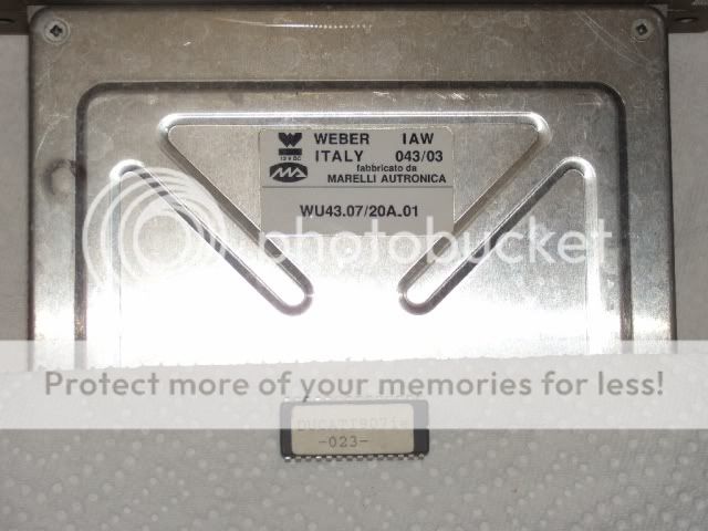

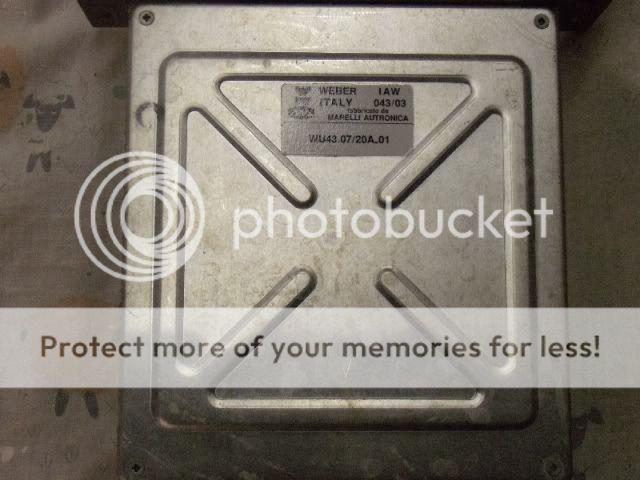

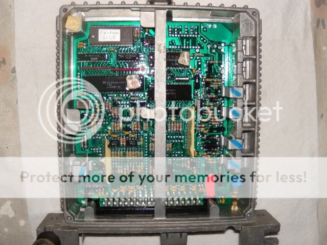

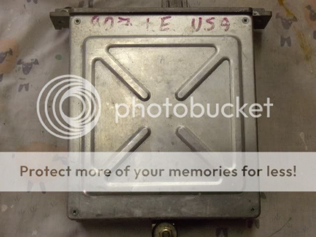

Here are a couple of pictures of my ECU with my customized chip.
Next picture is the inside of the ECU
Label side of the ECU
Other side of ECU (Notice the "907 I.E. USA") written on this side. Don't know who did this (factory?)
Close up of the ECU label with the "European" Chip that was in it when I got it.
The ECU originally came with the USA chip "023U" but was changed to the "023" chip you see in the photo above.
