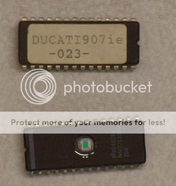

I'm pretty sure you have a FIM chip for "after market" slip ons. Here is a picture of the European chip (023) which has a richer mixture than the American chip (023U) because of the emission stuff. The other chip in the picture is an un-programed chip (the exact chip Ducati used, but there are newer versions) that you can buy. To erase and clear it you flash it with UV light through the window. After programming it you put a piece of tape or something over the window to keep light out.
