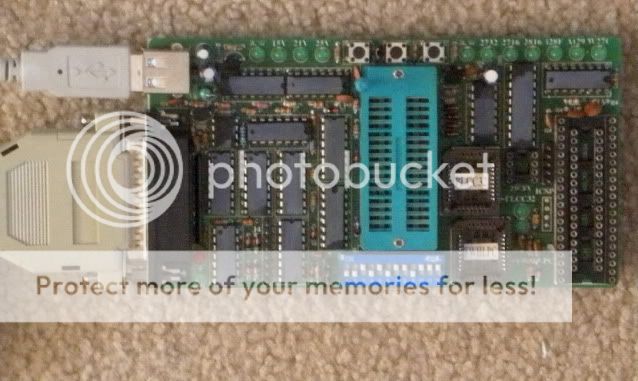

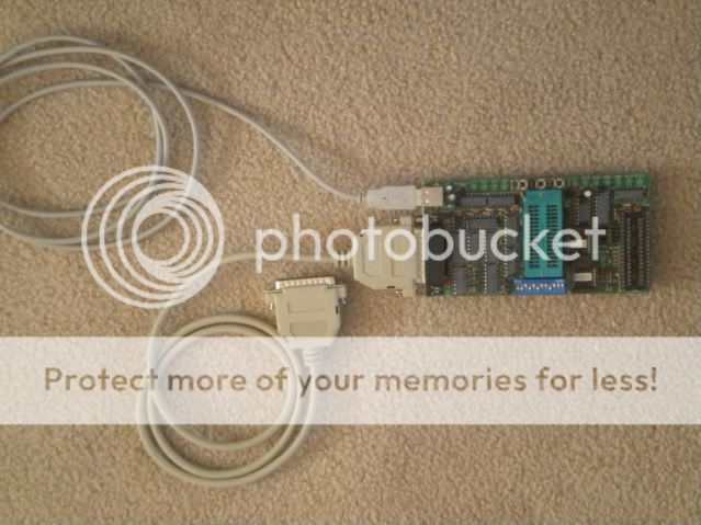

Here is a EPROM programmer that I got off of ebay. As I stated in the posting above I adjusted my TPS and balanced my throttle bodies. When you adjust the TPS you never can get it exactly back the way it was. So after getting everything adjusted my 907 was running way to lean. So I needed to get a chip that would make my engine run richer across the board. So a fellow on the internet offered a couple of bin files that he had made custom for his 907. I researched the OEM chip and model number and bought some locally and programmed them. The chip works great as stated in the posting above with the dyno chart. Anyway, enclosed is a picture of the programmer. It is an Enhanced Willem EPROM programmer. It comes with the windows software and both serial and USB connectors and cables. You can use either one, I just have them both plugged in for illustration purposes. You put the chip into the light green socket in the middle and set the dip switches according to the software. The LEDs are indicators for the voltages and etc. It has been awhile since I did this and I am no expert so I wouldn't be a good source for questions. I just thought this might help.
