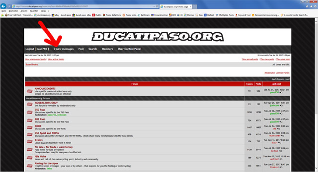

One of those dumb questions , what's that
Re: Oil leaks 89 900 ss
that's a private message. When you're logged-in you`ll find the link on top where it says "1 new message"
