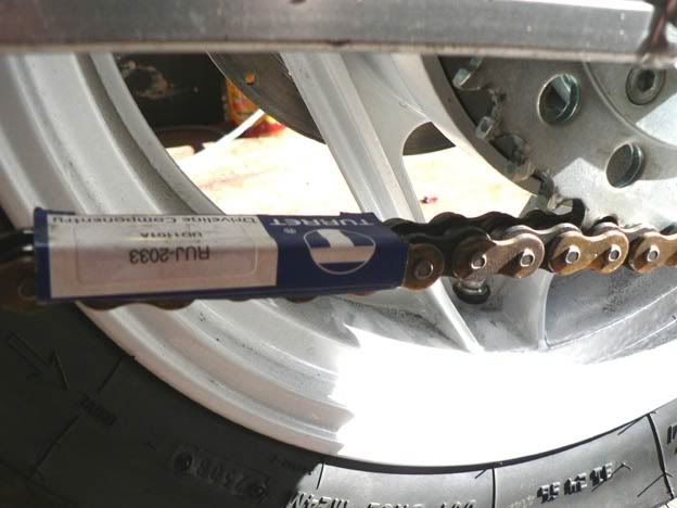

I took my Paso for its WoF yesterday afternoon and checked out the thread to report to those who have shown an interest. I was surprised to find a lengthy contribution from Mobius saying it's not possible to shift the chain 10mm. Aparently "Duane at the shop" knows better than me. Now I'm willing to admit an error - I've made plenty of them - but I need a little more information from "Duane" before I undo the work I've done. Where exactly on the frame is the chain going to "eat a whole"? I wondered if I'd made some massive blunder and overlooked something so I had a good look at the chain and the frame and I can't see where it is touching - never mind eating it. Wondering if there was something I couldn't see, I came up with a plan: I folded up a piece of cardboard, sat it on the chain and turned the rear wheel to follow its progress:
The cardboard made it all the way forward to the front sprocket. I tried it on the top of the chain with the same result. Then I thought maybe with my weight on the bike it may hit somewhere, so I sat on it and got my long-suffering wife to crawl on her hands and knees alongside to watch the piece of cardboard and report if it got jammed. It didn't, on the top or bottom. By looking along the chain and using this method with the cardboard I cannot for the life of me see where the chain is hitting.
Mctool may be right when he wonders if our bikes were not standard to begin with. That is why I checked my chain alignment before I started.
I think you are right to not "blindly" follow the process I have used. The internet is full of mis-information presented as fact. However, I have documented and illustrated the process I used on my bike for those who are interested in attempting a similar fix. Mobius I'm sure your engineer in Rangiora is vastly experienced and may have an alternative solution but as far as I can see, your main objection is the cost of modifying a rear sprocket every time it needs to be replaced. I think any capable machine shop should be able to bore out a sprocket and deepen the bolt hole recesses in an hour. A current charge-out rate where I live in NZ for that would be $60 - $80. I don't consider that a good reason for running a chain out of line.

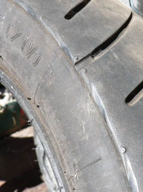

For those thinking that letting the chain rub the lip on the tyre sidewall will do no harm, here is the 160/70/16 that was on my Paso when purchased:
While pushing the bike in the shed the chain was being flicked up and down each time it rode over the ridges. I would hate to have seen it running!
Manufacturing tolerances and previous modifications may have made differences in the set-ups of our Pasos. I suggest that if you are considering moving your chain over on your bike - whether 10mm or whatever - first check your chain alignment and measure the clearance to whatever might get in the way - not forgetting the centre stand.
That way you should be able to discover clearance issues before they occur.

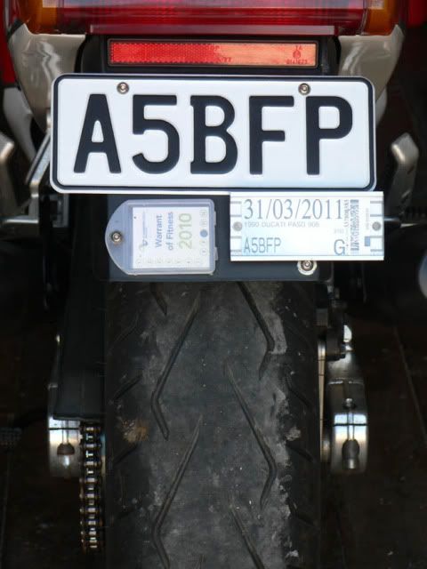

I took it out to my friendly WoF tester and talked over the conversion and the Paso's heavy steering at manoeuvring speed. Having said that, I am quickly getting used to being a little more careful at the bottom of my drive and from there on the bike feels perfect. Luckily a vastly experienced bike modifier I know was there changing a tyre and we talked pressures. Both agreed 34psi each was probably a better stating point so they were adjusted prior to the test ride.
I was under the impression my tester had ridden a Paso before but I was mistaken. He has ridden many bikes however - lots of Ducatis included - but it seems Pasos are pretty rare around here. However after the usual safety inspection, he set off on his circuit and I eagerly waited his return with fingers crossed. All was good. He was mostly impressed by how smooth it was and the handling was entirely acceptible. He wondered if the front fork oil was too heavy as it felt a bit hard under normal riding but said this may just be a Paso trait :dunno:
In short he considered the bike felt fine, looked great, and was happy to issue a WoF. I rode straight to the nearest Post Shop and celebrated by buying 12 months rego. It is so nice to have the bike finally ready for use.
