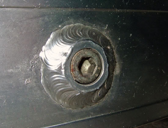

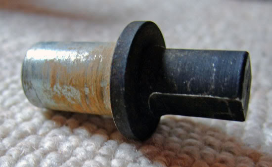

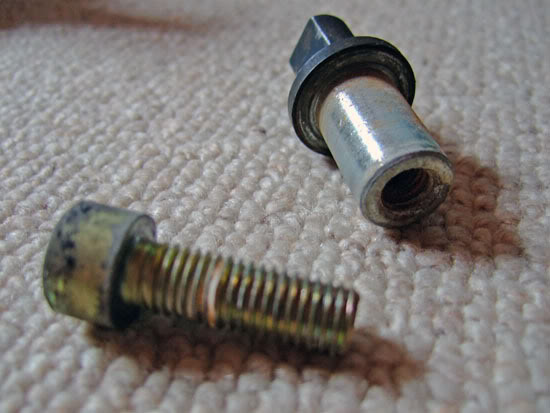

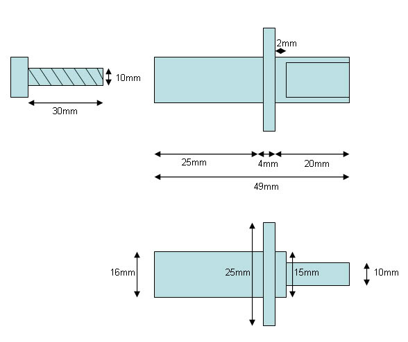

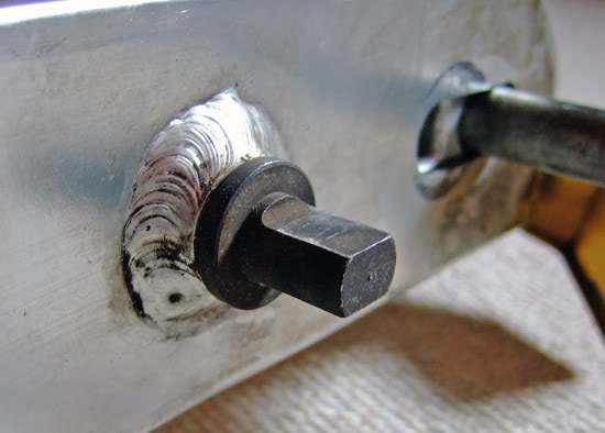

the pictures and measurements are made from a spare 907ie swingarm I`m keeping for similar reasons as you do

I gave the measurements for the pin to my machinist buddy, and he thinks he can probably make me one for less than Ducati probably wanted for one......it doesn't hurt that I was picking up $200 worth of parts for my Harley when I was talking to him about the pin.
