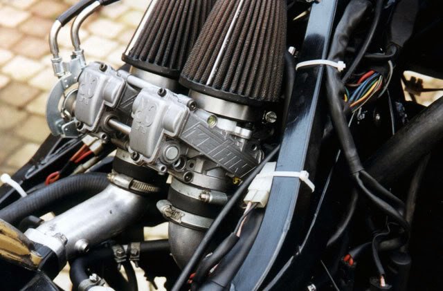

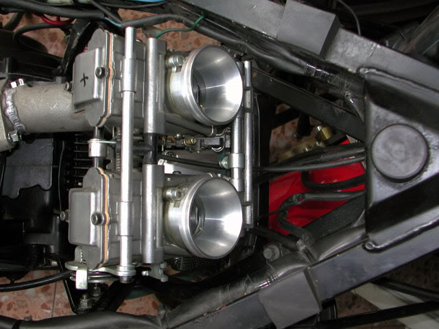

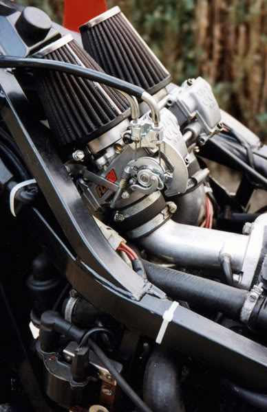

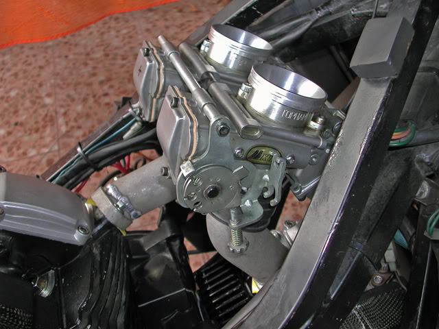

hi badhabrace i just got 900ss carbs to fit on my 906 can you take some photo's
of how they sit within the frame rails and also photo's of the way the wiring harness is routed on the bike thanks bob

Bob,
here some pictures of my Mikuni TDMR carbs and a friend`s ex-906 with Keihin carbs. Also with original Mikunis the position in the frame is the same.
[Image
You will find more info in the P750 FAQs.
