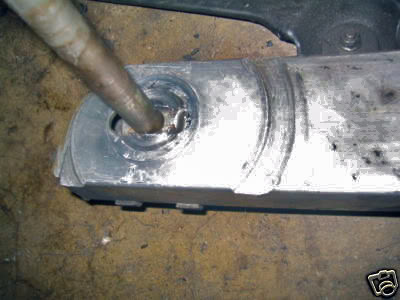

If the wheel didn`t turn when tightened my guess would be that the spacer was mounted the wrong way around.
If I remember well the spacer is conical and the larger side should show towards the swingarm. If mounted the wrong way around it would touch the inner and outer side of the sprocket carrier bearing. With the wheel being forced to spin the spacer would grind itself into the swingarm.
I`ve seen such swingarms. In worst case the axles losens, the wheel moves and the sprocket works itself into the swingarm also. (My mechanic currently has such a case on the bench).

The spacer is on the left but in your case on the wrong way around - I can confirm this I had exact same problem with my Monster after a tire fitter changed my rear tire.
The spacer will eat into the wheel bearing housing and then the sprocket nuts will eat into the swing arm, the handling will also feel a bit a bit strange as the wheel will run out of line - take it easy on left handers !!

- Posts: 5572
Re: rear axle nut torque specs?
here a pic of a 907ie swingarm that was on ebay. It shows what can happen
