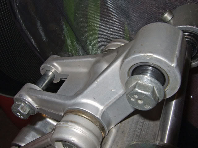

Well the frame is now just a shell ready for sandblasting which I hope to do over the weekend, I have managed to find several other cracks on brackets???
I know from the damaged bodywork and previous owners knowledge/history of the bike that it has had a few slow road slides so I wanted to check the frame for any strange twists or other damage thank fully there is nothing and to be honest the bike rode straight and true in the brief time I had her on the road before this stripdown.
I have found somewhere for the engine brackets however the one welded on the frame has a stress crack which was probably due to the front bracket being damaged so this will require a supporting weld
Can anyone confirm for me that this is the correct shape of the front fairing/headlight frame this is shown from underneath and is on the right side as you sit on the bike, if it was straight the frame itself would be crooked so I assume this is correct? Just confirming folks
This has been another real headscratcher for me is the bolt threaded in here or loose? As if it is, then I will have to drill it out as it siezed solid the two bracket bolts were the same only I eventually persuaded them with brut force and heat to pop out - BUT NOT WITH THIS ONE
The starter motor bolt is badly corroded and I will have to grind this off and renew I will also sort out the earth adaption shown elswhere on this site while I am about it aswell.
I found one other bracket a bit twisted and cracked also, this looks like its made of an alloy metal?
There is more to come and lots of fun - wait till you see the state of my body panels that I am starting repair???

Jesus, you sure have got some work on there. Don't worry about the steel welding, its really easy. I regularly make brackets and entire assemblies from plate steel with a MIG welder and I'm no expert.
it`s loose. There`s no thread in that part.
