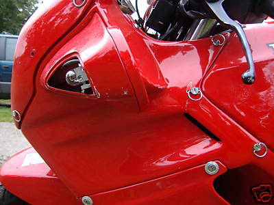

Just thinking.... might convert to Dzus' but I'd like to see what it would look like 1st. Anyone done it and have pictures?

I thought of it once but after seeing this picture I changed my mind again
Re: Anyone converted to Dzus'
I went as far as to buy a set,but even tho the screws are a pain in the arse they do look good
