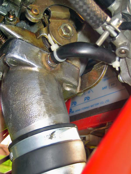

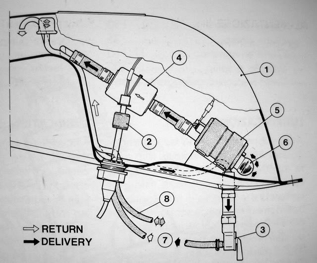

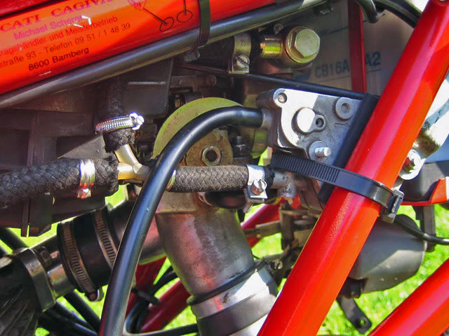

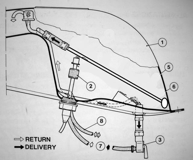

This autrian guy (http://www.8ung.at/manxman/Opti/Sportopti.htm) swapped the fuel pump with an external one.
Short translation. Below the carb on the inlet manifold there`s the connection for the syncronisation tester. Swap the screw with a screwed nipple. The tube for the underpressure connection should not be a soft one. Then he removed the pump from the tank and replaced it with a tube that reached to the tanks bottom. At the end he fixed a mesh filter (with a cable tie).
He kept the Y connector before the carb (the return line).
He says this changed the behaviour of the engine/carb very positively, too (next to ca. 300ccm more fuel capacity in the tank)
original
modified
original
modified

Re: Fuel Pump
Nice pics, and a very nice graphic that shows why you can't simply yank the fuel pump in the Sport.

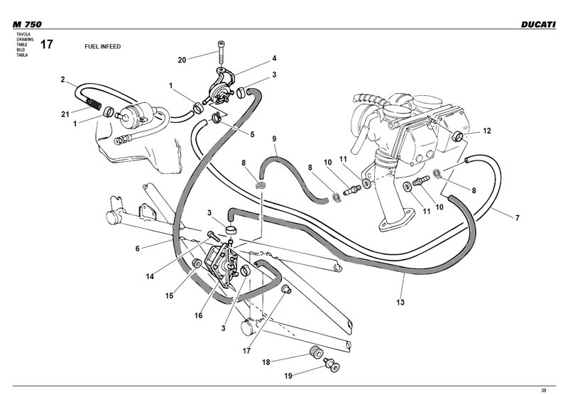

Re: Fuel Pump
this is from a Monster parts catalogue
(Phil, number 4 is the fuel valve so it`s not integrated in the pump, but it`s also underpressure activated)
I guess fuel pumps with 4 connections may be the ones with an integrated valve.

Re: Fuel Pump
Interesting. They used one of the vacuum lines to turn on the fuel, and another to pump the fuel. Since I have Dellortos on my Sport, I should probably use one for the fuel valve, and one to run to the Magnet Marelli ecu.
